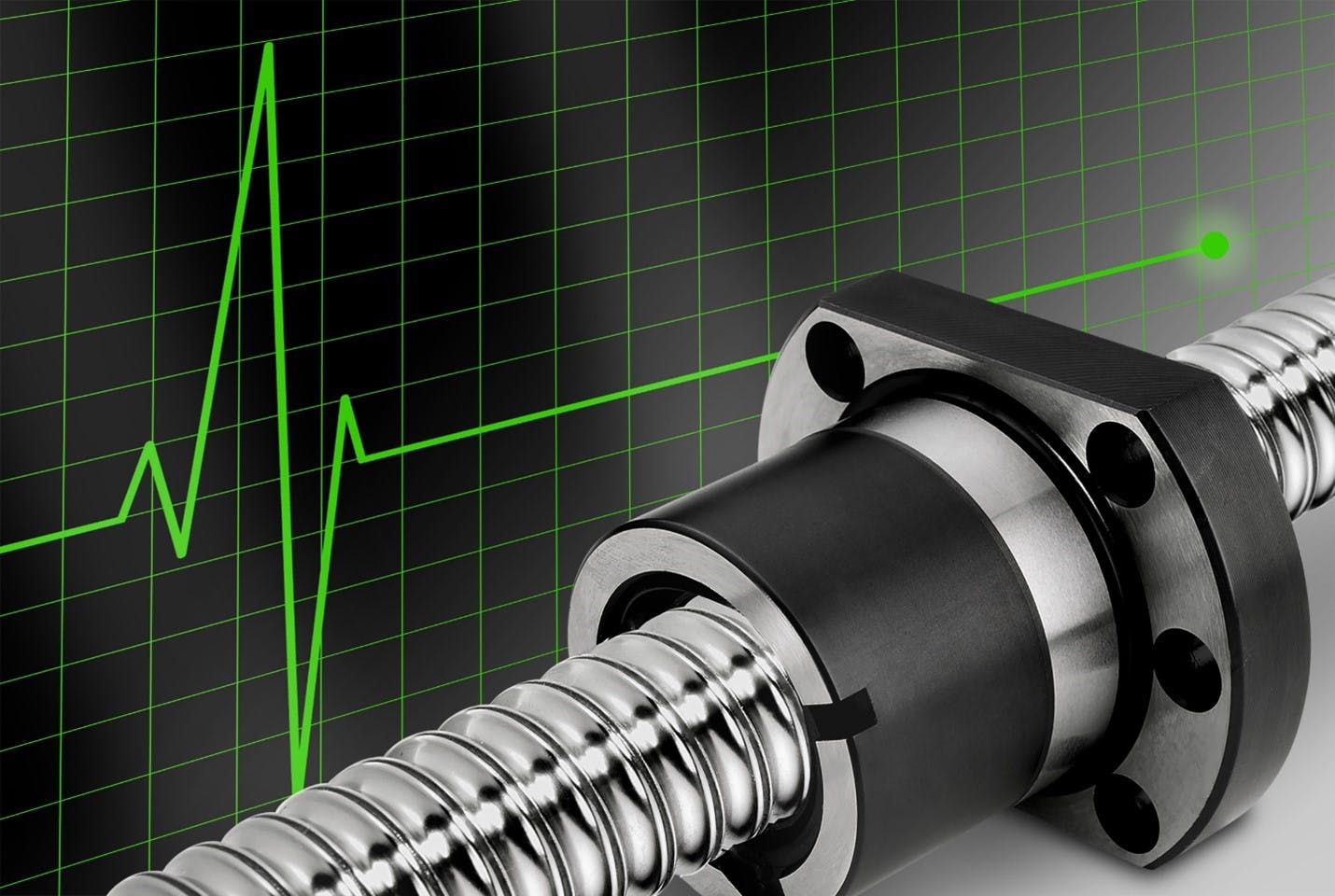

When designing drive systems, ball screws are still the most widely used components among designers due to their high performance and the associated energy efficiency. To properly size a ball screw into an application, the required load capacity and service life must be known.
Premature failure of a ball screw in the field can lead to unnecessary downtime and other unpredictable consequences. However, the signs indicating potential failure are often unclear (Figure 1), and if there is a problem, time-intensive and costly troubleshooting may be needed.
For example, it may be necessary to remove the ball screw or even the entire ball screw drive assembly from a machine. Users can avoid such inconveniences by paying close attention to seven important installations, operating and maintenance issues that can shorten the service life of a ball screw.
