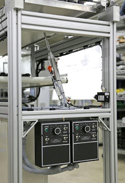

In the ever-growing automation industry, T-slot extrusion provides a stable base for robotic arms and other automation equipment, enhancing precision and efficiency. Profiles can also accommodate mounts for accessory equipment such as monitors, keyboard trays and control panels (Figure 2). This enables the creation of ergonomic workstations where operators can monitor and control automated processes efficiently, and adding casters can create rolling carts with equipment for hospitals and clinics.
