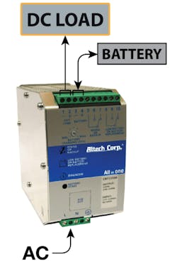

A DC UPS serves a similar purpose to its alternating current (AC) counterpart but operates with AC or DC power sources and is tailored for applications where DC power is used. Essential features and functions of a DC UPS in safeguarding electronic equipment during power fluctuations and outages include battery backup for the whole system; voltage regulation for the load; surge protection for the system; monitoring and alarms functions; automatic or controlled shutdown capability; higher efficiency than AC back-up systems; remote monitoring and management ability; easy customization for specific applications; and simple maintenance and serviceability. Overall, a DC UPS is a critical component for ensuring continuous operation and protecting against power disruptions in DC-powered applications.
