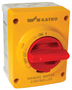

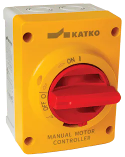

Klaus Tum: The primary function of a disconnect switch is to safely turn the power on and off. A disconnect switch usually is part of the power circuit of a panel that controls various aspects of machine operations. The use of a shaft and external door interlock handle along with the disconnect will ensure that the panel door can only be opened when the power is turned off.
Disconnect switches can also be used in secondary and/or control circuits to control power to an individual circuit or a bank of individual circuits. The disconnects are then used with different handles or door mount kits as they sit on the inside of the panel and where the door interlock function is not necessary or required.
MD: How do the various types of disconnect switches—such as fused, non-fused and enclosed switches—differ in their applications within industrial machinery?
KT: Fused disconnect switches are used in place of large, molded case circuit breakers (MCCBs). Non-fused disconnect switches are used when the application requires a “power” switch and circuit protection is provided by other means such as a large MCCB, miniature circuit breakers (MCBs), fuse, etc., downstream.
Enclosed disconnect switches are predominately used close to the load. For example, the National Electric Code (NEC) requires a “local” disconnect in line of sight of a motor. They are also used on the outside of panels where the control of a certain circuit is essential, but access to adjacent circuits inside the panel is not necessary.

KT: In short, making is closing the circuit; breaking is opening the circuit. Altech/Katko disconnect switches do not differentiate between the two operations. The internal switching mechanism is mirrored in both directions (of operation). They are UL tested during short circuit tests (so-called “O” and “CO” shots) and overload/endurance tests (6,000 operations under current load/4,000 operations with no load) to simulate these making and breaking conditions.
