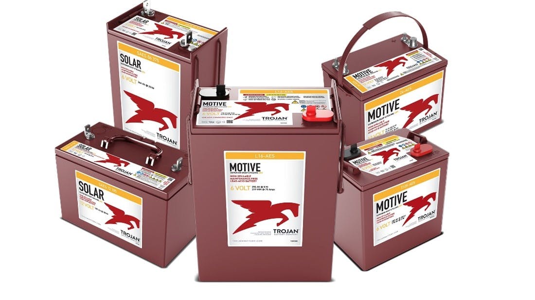

Figure 3: New batteries have advanced design features to extend battery life and simplify maintenance.

Again, battery design advances aid in maintenance to help ensure long battery life. For example, watering is not required in the AES AGM batteries (figure 3), eliminating this costly step.
