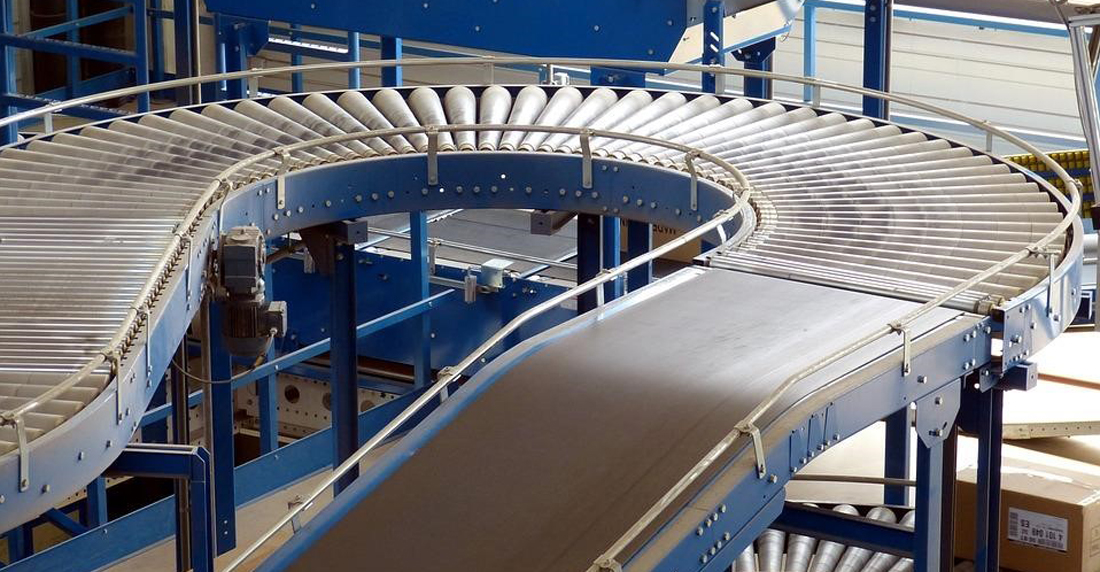

Fig. 1
What’s the Difference Between Conveyor Systems?
