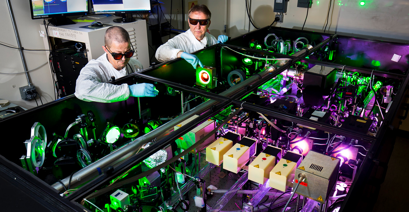

The initial 300-TW Hercules laser on which Zeus is based. (Courtesy: Joseph Xu, College of Engineering, University of Michigan)
