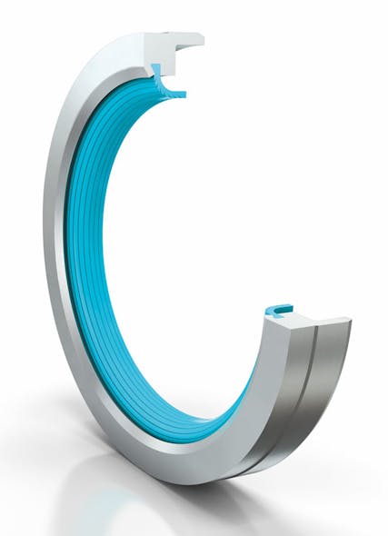

The HiSpin HS40's hydrodynamic feature helps reduce frictional torque, while oil back-pumping leads to improved sealing performance without causing any shaft damage.

Developments are now seeing specialized sealing solutions meet the requirements to support the evolving electric vehicle sector, often exceeding electric vehicle manufacturers' target speed of at least 130 feet per second. Some seals perform comparably relative to critical torque and power consumption and exhibit zero leakage, despite the highly demanding sealing conditions. In one case, a seal reduced friction 75% compared to a standard seal of its type. And it proved capable of operating at 200 feet per second.
Trelleborg's engineering innovations are working to extend drive time in electric vehicles.
Test results for these specialized seals meet key parameters with test procedures that take into consideration requirements of the electric vehicle manufacturers, reviews of multiple sets of application data, and discussions with major automatic transmission fluid (ATF) and bearing manufacturers. Tests were performed on a 38 millimeter shaft at rotation speeds of up to 21,000 RPM (130 feet per second) in temperatures ranging from −40°F to +302°F in ATF oil mist conditions for a duration of a 500-hour accelerated load cycle test. This represented real driving conditions, including reversing, city driving, stopping and starting in traffic jam, and high-speed highway driving. In addition to the 500-hour accelerated load cycle test, seals were subjected to more than 3,000 hours of endurance testing.
The newly developed seals passed the accelerated load cycle test with no leakage and no wear on the sealing lip or shaft. In fact, the wear on the running surface was barely noticeable and Finite Element Analysis (FEA) results all proved positive. The one seal utilizes polytetrafluoroethylene (PTFE) based material ensures compatibility with virtually all media. A second design is in proprietary low temperature FKM fluoroelastomer. To meet electric vehicle manufacturing needs required fluid compatibility testing—specifically, long-term immersion in ATF commonly used in electric drive systems for 168 hours at +284°F and 500 and 1,000 hours at +257 °F. Compared to terpolymer FKM, ethylene acrylic rubber (AEM), and acrylic rubber (ACM) materials, the FKM elastomer demonstrated significantly less volume change and excellent retention of chemical and mechanical properties.
