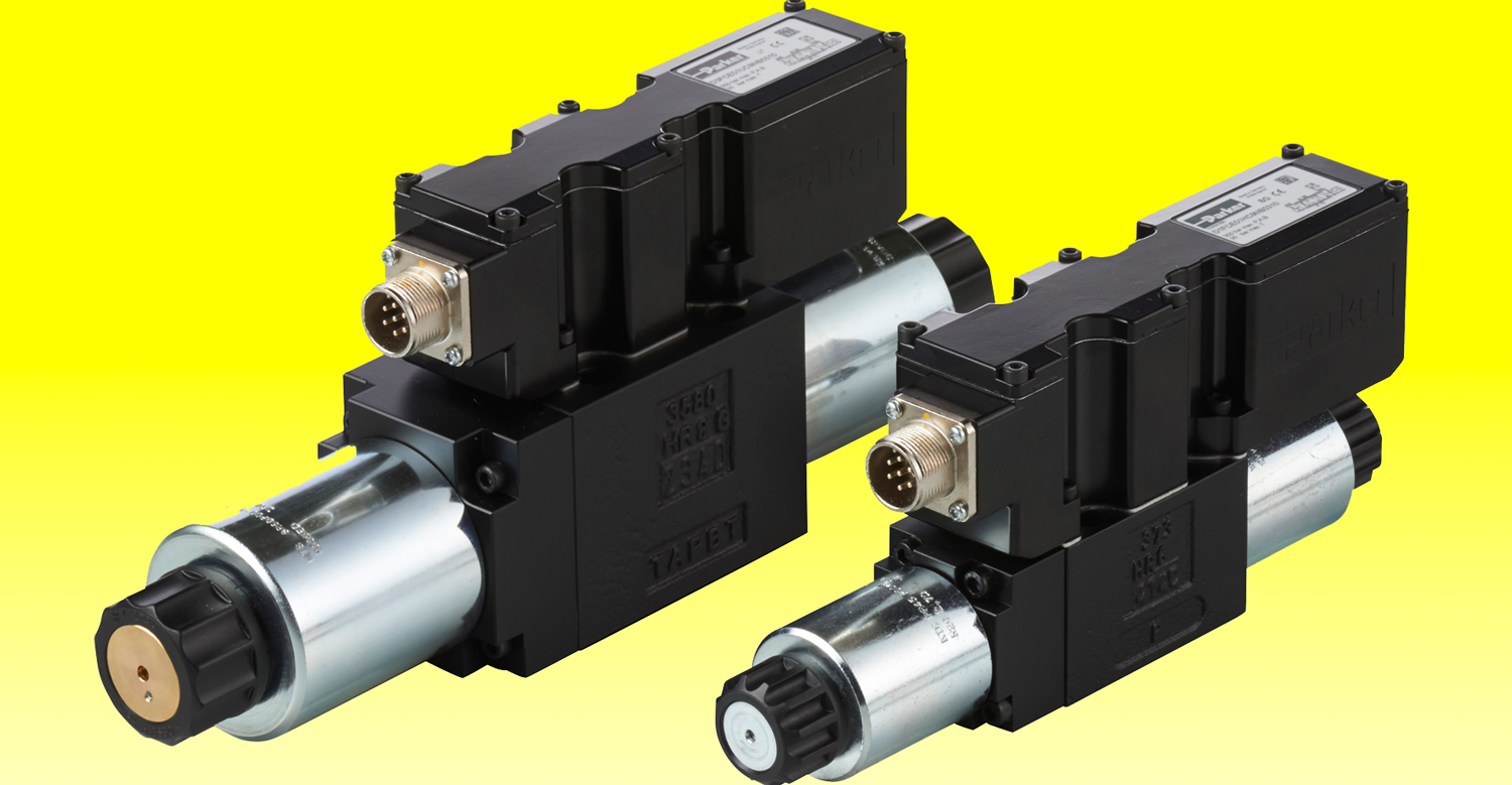

The Series D3FP direct-operated control valve from Parker Hannifin combines high dynamics with high flow. It is used for precise accuracy in positioning hydraulic axis and controlling pressure and velocity.
