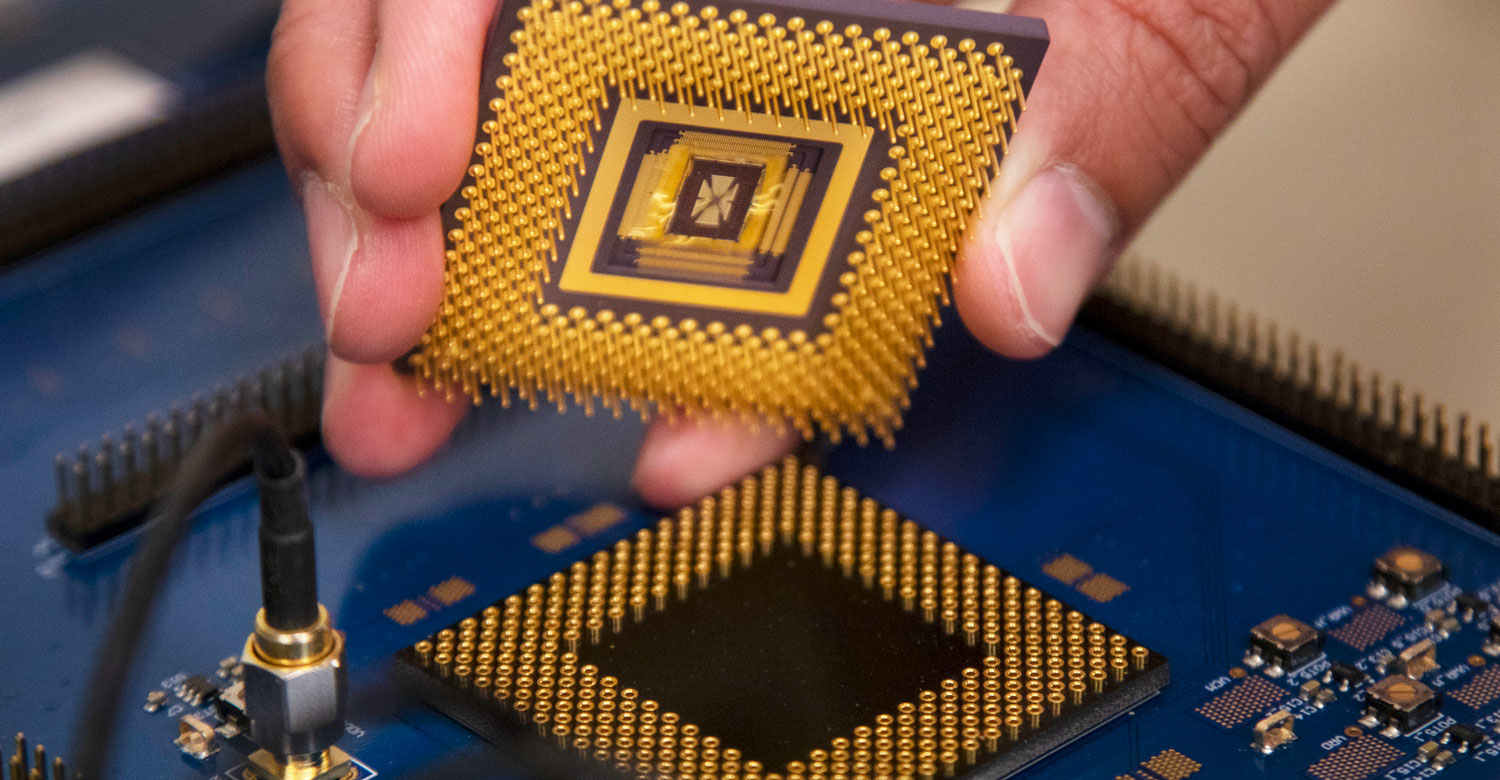

Wei Lu stands with fellow researcher Seung Hwan Lee, an electrical engineering PhD student, who holds the memristor array. (Courtesy: Robert Coelius)
