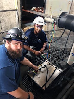

NIST’s Joey Boyd (left) and Aaron Johnson test the new sensors at a power plant. The platform, which gives them access to the smokestack, is about 144-ft above the ground.
In the NIST tests, four probes, or pitot tubes, were inserted horizontally into the smokestack. The four probes each measure flow measurement at four different spots, for a total of 16 measurements. With this information, NIST engineers could test the precision and accuracy of a new pitot tube design and measurement method.

The coal-fired plant had an enclosed platform where the pitot tubes were inserted into the smokestack. But the natural gas plant’s platform was open to the elements. And at roughly 145 ft in the air, “things shake,” says NIST technician Joey Boyd. “While you’re working, the stack is swaying, and the floor beneath you is moving.”
