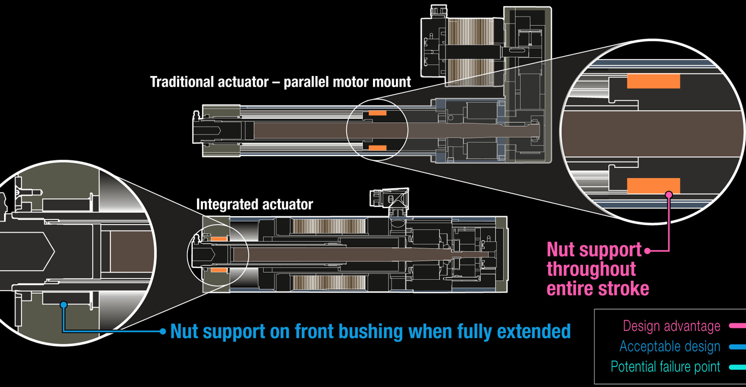

Traditional actuators provide better nut support which allows for longer strokes.
Both traditional and integrated actuators use fixed/free screw supports. One important difference between the two actuators is the roller/ball nut is supported at the point it attaches to the thrust rod in traditional actuators. The support moves with the actuator through the entire stroke. With the nut’s support, typical traditional actuators can have 1.5-m strokes. An integrated actuator, however, uses a hollow-core rotor, which cannot provide nut support throughout the stroke. This results in strokes limited to 600 mm for some models because the fixed-location nut, known as thrust rod front bushing, does not travel throughout the stroke.
Traditional actuators provide standard internal anti-rotation mechanisms while maintaining IP ratings.

The nut support for traditional actuators serves a second purpose by providing anti-rotation, which is necessary for linear motion. The nut contacts and slides along the actuator housing extrusion, allowing for anti-rotation throughout the stroke. Integrated actuators typically use the design prevent rotation. If anti-rotation is required, external guide rods or special thrust rods such as a hex shape or spline are options. Both splined and hex rods provide internal anti-rotation, but sealing challenges make them difficult to use in applications requiring IP65 ingress protection ratings.
