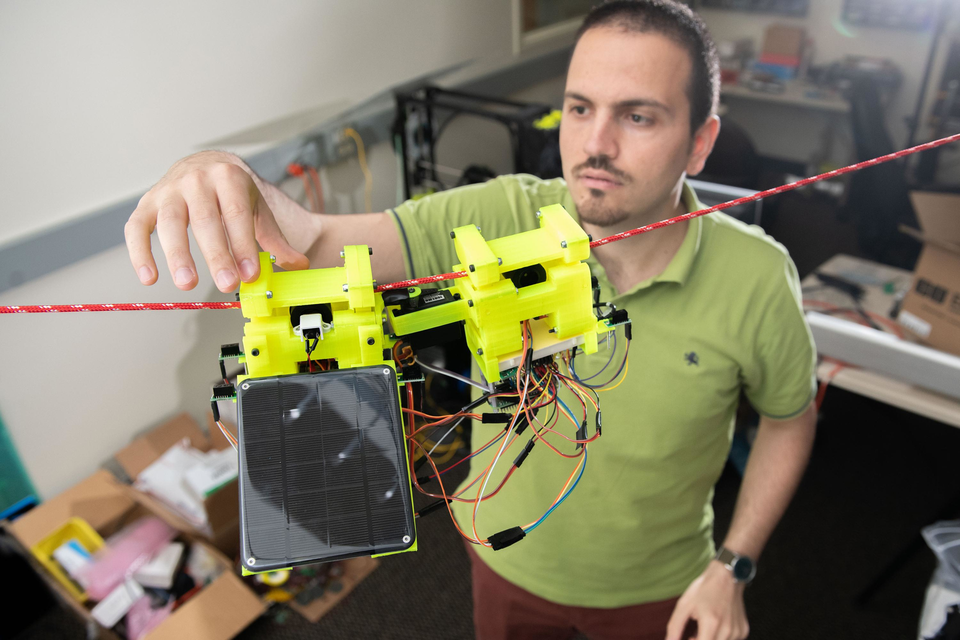

Based on what Egerstedt called the “theory of slowness,” grad students Gennaro Notomista and Yousel Emam built SlothBot using 3D-printed parts for the gearing and wire-switching mechanisms needed to crawl through a network of wires in the trees.
The gears and switches that let the robot switch from one cable to another were made using 3D printing.(Photo: Allison Carter)
The greatest challenge for a wire-crawling robot is switching from one cable to another without falling, says Notomista: “The challenge is smoothly holding onto one wire while grabbing another. It’s a tricky maneuver and you have to do it right to provide a fail-safe transition. Making sure the switches work well over long periods of time is really the biggest challenge.”
Mechanically, SlothBot consists of two bodies connected by an actuated hinge. Each body houses a driving motor connected to a rim on which a tire is mounted. The use of wheels for locomotion is simple, energy-efficient, and safer than other types of wire-based locomotion, the researchers say.
