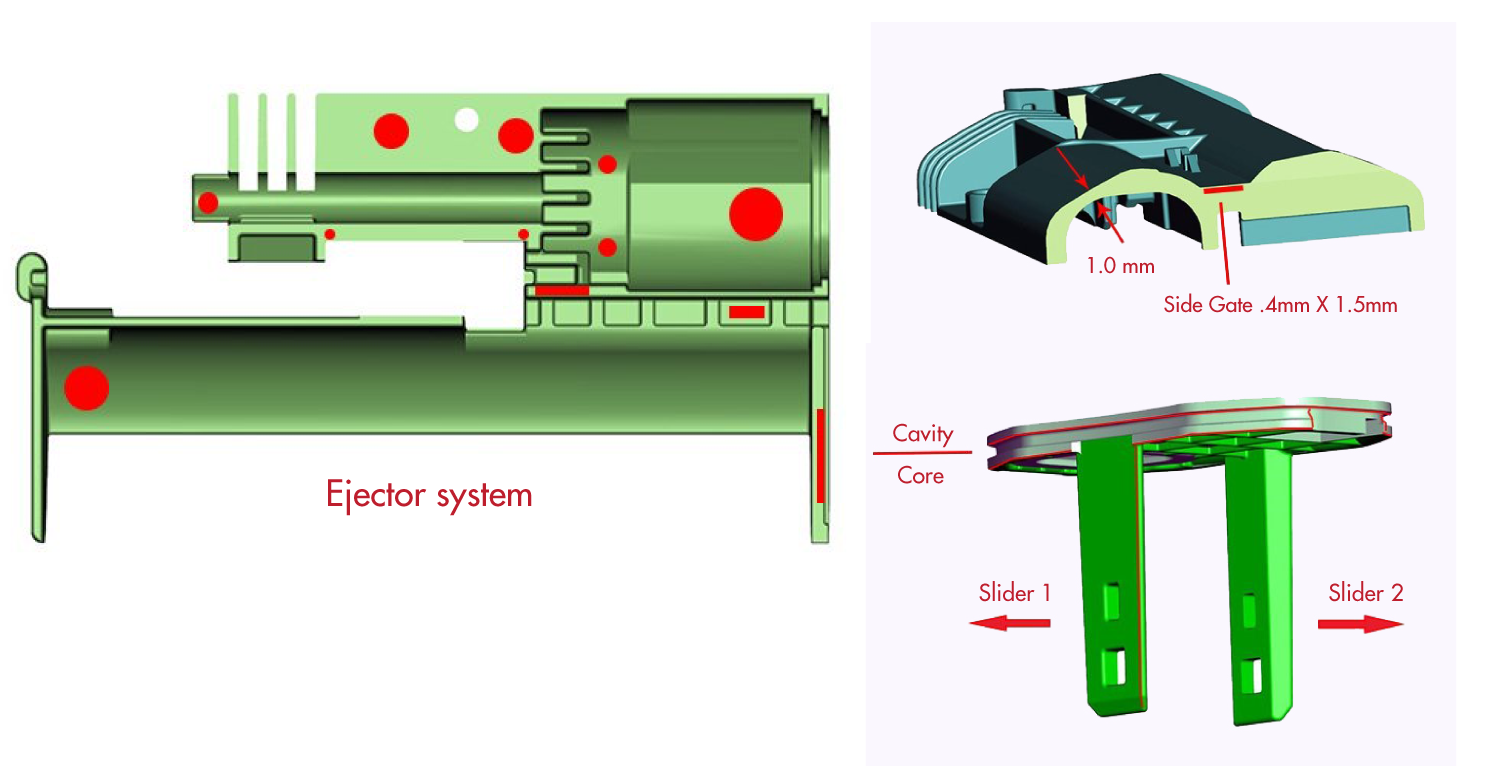

Design for Ejection
The application of ejection force should be balanced out over the surface area of the part—taking into account thickness and mass—to keep the part from warping or breaking. Additionally, in the area surrounding the gate, stripper plates or additional ejector pins will be needed. These pins are necessary to clear the gate of plastic in the event of a short shot.
5. Geometries are challenging to balance.
Since the area near the gate will be under stress, it’s good practice to make the wall thicker if possible or create pads or other flat areas to provide a push-off for the force of the pin to act against.
