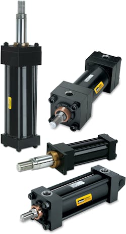

Hydraulic cylinders are complex devices incorporating a wide range of individual components in a multitude of dimensions, configurations and materials.

Cylinder manufacturers can offer options that increase the chances properly equipped standard components will meet an application’s design criteria of an application. For example, most cylinder manufacturers offer 19 mounting options, which covers the standard NFPA offerings. Standard components have the additional advantage of being readily available worldwide, expediting just-in-time warehousing and delivery of replacement parts as components eventually wears out.

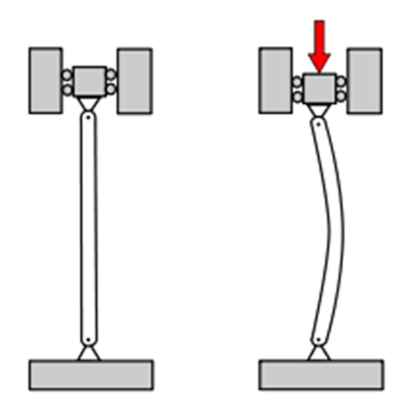

Necessary column strength is often overlooked when selecting rod diameters. In addition to considering how much force it can push with, also ask, “How strong is this column extending out here?” If we don’t work with engineers in the design phase, we likely don’t know if it’s a compressive or tension load. Column strength is the parameter that gets overlooked most often when selecting piston-rod diameters.

Necessary column strength is often overlooked when selecting the rod diameter for a hydraulic cylinder.
