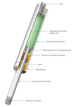

Gas springs are self-contained, force generating, maintenance-free cylinders. The body is filled with pressurized nitrogen gas that generates a specific pressure. The pressure pushes on the piston, which provides the output force in push-type gas springs. As the piston rod is pushed and compressed, the piston generates a constant output force and controls its velocity by metering nitrogen through a hole. A little oil dampens, or cushions, piston movement at the end of travel when the gas spring is mounted with the piston rod facing downward. Some gas springs have a field-accessible vent valve for venting nitrogen to reduce the spring’s force.

Finally, gas springs should be installed with the piston rod downwards. As a gas spring nears full extension and the piston rod reaches the bottom, it travels through a small oil chamber which provides end damping to soften the motion. The chamber helps keep the seal lubricated to extend the life of the gas spring, and it allows for alternative mounting configurations.

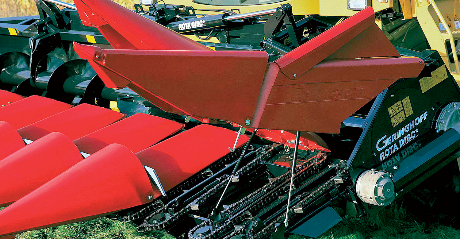

Gas springs prevent injuries during maintenance on harvesting machines such as this reaper. The blades of corn picking devices are arranged under plastic hoods. For maintenance, the 15-lb hoods must be lifted. To protect  maintenance personnel from injury and keep hoods from falling, the hood is kept in the open position by GS-22 industrial gas springs. As an added advantage, gas springs offer added stability under rough operating conditions due to a wear-resistant coating on the piston rod and housing.
