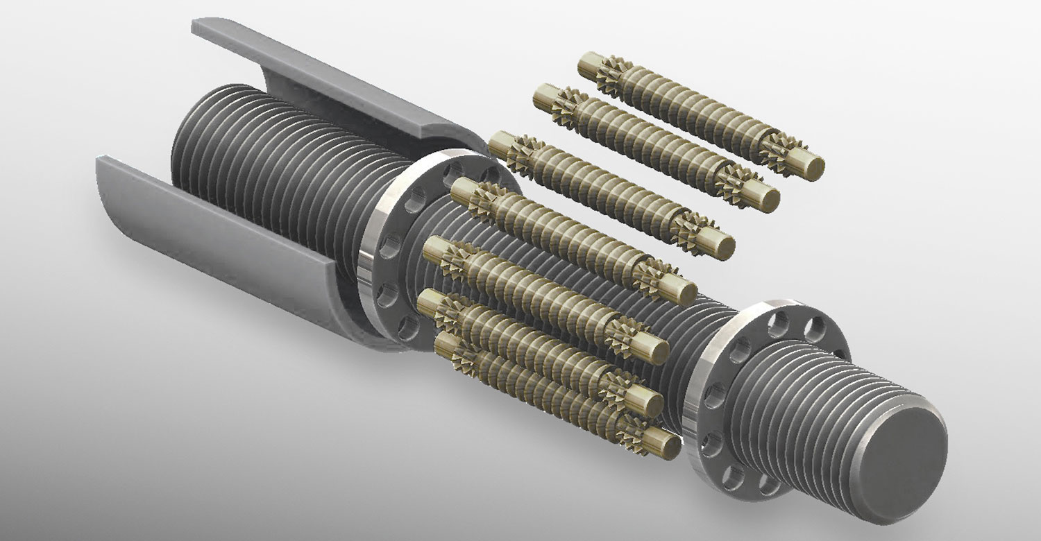

For higher loads, engineers specify roller screws. In a roller screw, the load-bearing mechanism is a set of recirculating rollers instead of balls. The rollers have more surface contact area than balls, so the load carrying capacity increases, and so can the service life.
But these benefits come at a premium. Compared to relatively simple, time-tested ball screws, roller screws require extensive upfront precision machining and more complex assembly. This contributes to the roller screws’ overall higher costs and larger installed size.
Roller screws consist of a set of recirculating rollers. Roller bearings with grooved rolling elements have more total surface contact area than balls. As a result, service life and load-carrying capacity increases.
