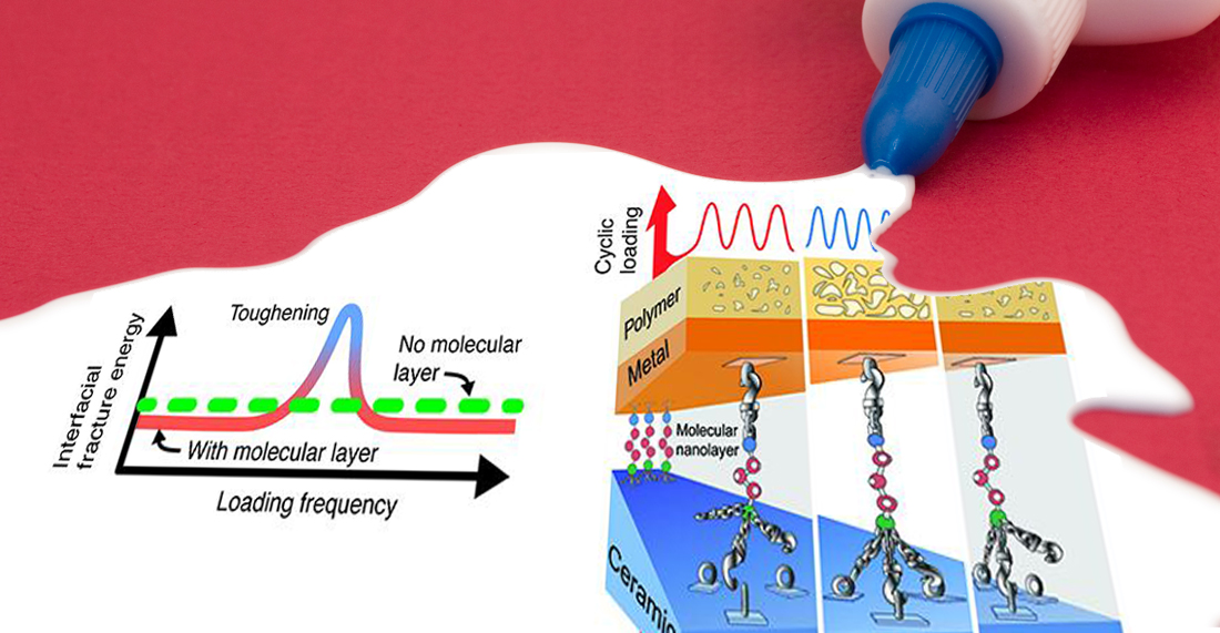

Ramanath and his team of collaborators found that, at certain loading frequencies, the energy required to fracture a nanoglue-modified polymer-metal-ceramic composite tripled and exceeded the static loading fracture energy. This behavior was unexpected and is significant, because fracture energy is typically lower during cyclic loading than during static loading. Such frequency-dependent toughening was observed only when a nanoglue layer was used to bond the metal and ceramic.
The illustration on the right shows a cross-section of a polymer-metal-nanoglue-ceramic composite. The graph shows the frequency-dependent toughening phenomenon.
The results also show that although the nanolayer is necessary for toughening, the frequency range and extent of toughening depend primarily on the mechanical properties of the polymer in the composite. Specifically, the nanoglue facilitates load transfer across the metal-ceramic interface and dissipates energy in the polymer through plastic deformation, leading to an increase in fracture energy.
