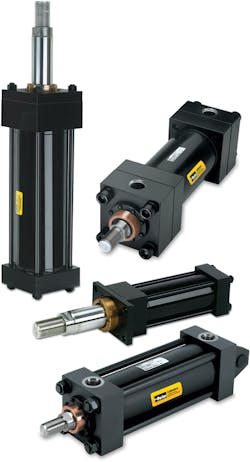

Hydraulic cylinders essentially convert fluid pressure and flow into force and linear motion. They are available in a wide range of styles, sizes, materials, and configurations. Many OEM engineers play it safe by over-engineering cylinder specifications. But less can sometimes be more when it comes to complex hydraulics. Let’s first identify some of the key factors that should be considered when specifying hydraulic cylinders.

For mounting cylinders, the best practice is to use a mounting style that absorbs forces on the cylinder’s centerline. If the piston is rod is primarily loaded in tension (pull), use head end mountings such as Style J and JB. If, however, the piston is primarily loaded in compression (push) use end cap mountings such as Style H.
Several standardized mounts within these styles give engineers alternatives for meeting application requirements. NFPA tie-rod cylinders, for example, are used in most industrial hydraulics and are typically mounted using trunnion-style heads and ; extended tie rod caps and/or head end styles; flange-style heads; side-lug and side-tapped styles; spherical bearings; and cap-fixed clevis designs. Most mounting options are available for single-acting and double-rod cylinders.
The purpose of the mount is to absorb forces, stabilize the cylinder, and improve performance. For rods loaded primarily in compression (push), cap-end mounts are recommended. For those in tension (pull), head-end mounts are preferred. The amount of tension or compression determines piston rod diameter. The amount of pull or push determines the bore diameter.
