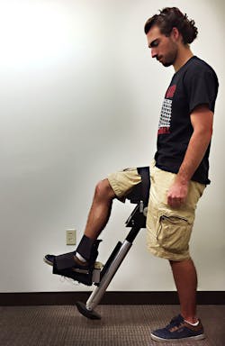

The “Clutch Crutch” is an ergonomic, hands-free crutch invented by six Purdue University grad students.
A group of six Purdue grad students, including the two who were injured, formed the Clutch Crutch Team to invent a recovery device for injuries below the knee that would let patients more easily go about their lives with little to no difficulty during recovery process. Goals for the device included not slipping on icy surfaces, the ability to put on and remove it with ease, and avoiding constricting any major blood vessel, nerve endings, or glands. The user should also be able use it to stand comfortably and move using it without needing excessive energy.
The team then went about designing a prototype. It aimed to design a device that redirects pressure to the quadriceps, the muscle at the front of the thigh. A relatively strong muscle compared with the rest of the body, it can provide adequate support without causing any nerve ending damage or adding pressure to the injury.
Creating a prototype took time and much deliberation. Nevertheless, a prototype was built that fit all of the team’s requirements. They students also instrumented the crutch so that doctors and medical staff could get real-time data on how much force was being placed on the injured leg to aid in tracking progress. The Clutch Crutch also lets the injured person walk easily on different terrain and even stairs.
