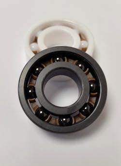

Ceramic bearings are resistant to acids and alkalis and used in very corrosive environments. (Image credit: SMB Bearings)
Ceramic Bearings
Full ceramic bearings have ceramic rings and balls, and either a synthetic cage made from PEEK or PTFE or no cage at all. They are highly resistant to acids and alkalis and are therefore suitable for use in very corrosive environments. Silicon nitride (Si3N4) bearings can be heated to temperatures of 800°C when used without a cage. Pairing these qualities with their lightweight nature (at 45% of the weight of steel bearings), they are incredible substitutes for traditional metal bearings.
Full ceramic bearings are also non-magnetic, meaning they can be used in medical devices such as MRI scanners or any application where there is a strong magnetic field. However, the greater hardness of ceramic bearings also means greater brittleness and, as such, they do not tolerate shock loads well.
