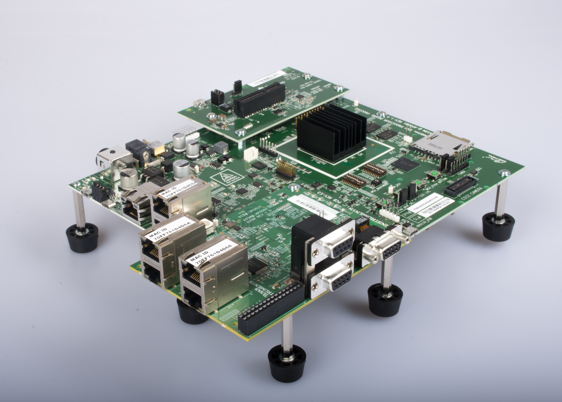

As with most things, there are also tradeoffs when moving from traditional microcontroller- or field-programmable gate array-based designs to processor-based servos. Designers need to learn new development environments and become familiar with real-time operating systems as well as high-level operating systems like Linux, depending on which features you want to enable. Additionally, where you gain integration from the system-level perspective, you lose some from an SoC perspective when compared to a microcontroller.
Microcontrollers typically have embedded flash memory, integrated power management, and integrated Ethernet physical layers; with a processor, these components are typically not integrated and thus contribute to the total bill-of-materials (BOM) cost. That’s not to say that a processor-based system will be more expensive overall, however, since system-level integration could remove more expensive components like industrial communication application-specific integrated circuits. But at the component level, processors often cost more than microcontrollers.
TI Sitara AM6x processors featured in the AM65x industrial development kit.
Although there is a barrier to entry for a processor-based system, it appears that the industry is moving toward this architecture. We’re excited to see exactly where the servo drive market goes in the coming years, especially with the other revolutions going on in the factory world like Time-Sensitive Networking, or TSN. Luckily, there are processors on the market, like those in Fig. 3, that are ready for these next-generation systems.
