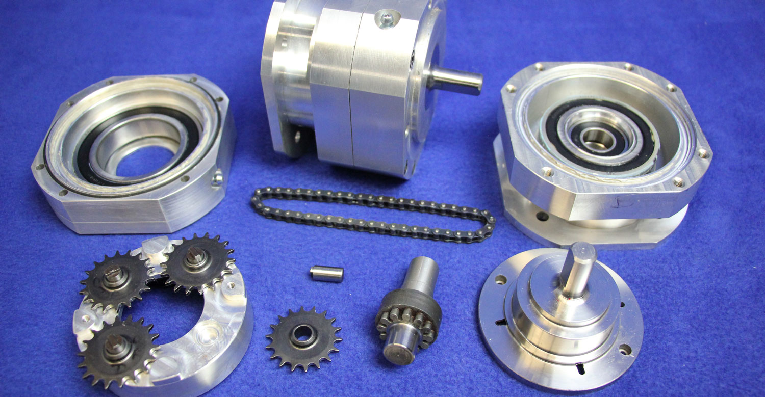

This gear drive from Gearing solutions uses six planetary gears and roller chain.
Adding the Rolling Ring
In the latest innovation, the planetary gear set’s ring gear has been replaced with a roller chain. Also known as a bush roller chain, this is the chain drive commonly used to transmit mechanical power on many kinds of machinery. One of the most common examples is the bicycle chain. It consists of a series of short cylindrical rollers held together by side link and is usually driven by a toothed wheel or sprocket. They are simple, reliable, and efficient.
There are actually two types of links alternating in the bush roller chain. The first type are inner links with two inner plates held together by two sleeves or bushings upon which two rollers rotate. Inner links alternate with the second type, the outer links, and they are made up of two outer plates held together by pins passing through the bushings of the inner links.
The roller chain design reduces friction compared to simpler designs, resulting in higher efficiency and less wear. The original power transmission chain varieties lacked rollers and bushings, with both the inner and outer plates held by pins which directly contacted the sprocket teeth; however, this configuration exhibited extremely rapid wear of both the sprocket teeth and the plates where they pivoted on the pins. The addition of rollers surrounding the bushing sleeves of the chain provide rolling contact with the teeth of the sprockets, resulting in excellent resistance to wear of both sprockets and chain. There is even very low friction, if the chain is sufficiently lubricated. Continuous, clean lubrication of roller chains is of primary importance for efficient operation as well as correct tensioning.
Developing a planetary gear that uses a roller chain to form the internal gear allows for a more compact gearset and the option to use lightweight aluminum casings. The chain provides a wide range of sizes and ratios. For example, if using only a sample of 27 to 100 pitches, nine chain sizes, and 10 ratios, 657 sizes can be configured. Each ratio has its own set of variables, creating thousands of possible combinations. This lets the gearset maintain high levels of energy with minimal energy loss. Newer devices also require less electricity or fuel to operate, which helps increase efficiency.
