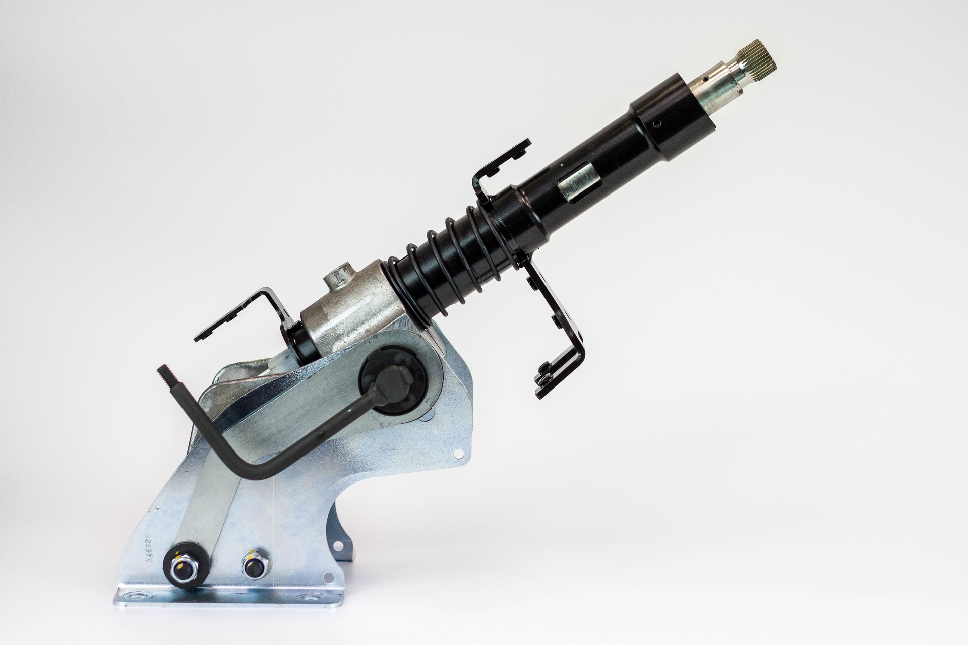

Fig. 1

The drop arms pictured above are an essential part of a vehicles steering mechanism.
