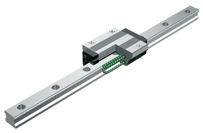

Optimizing the Preload
Preload is the force applied to an unloaded bearing to adjust the amount of clearance between the bearing element and the raceway. In a bearing incorporating balls or rollers, the preload is modified by changing the diameter of the rolling element. The amount of preload applied can be used to adjust the stiffness (and friction) of the bearing.
The larger the ball, the stiffer the system—and the converse is also true. In the clean-room application discussed above, for example, reducing preload by switching to smaller balls can compensate for the increased friction introduced by the clean-room grease.
Stock bearings arrive with a standard preload set at the factory. That does not mean design engineers don’t have options. To achieve the exact amount of preload necessary for the system, skilled technicians can swap out balls of 1 mm increments. The high degree of granularity in preload can be used to fine-tune performance.
A customer with a vertical application could use preload to, for example, increase friction in the system and reduce requirements for a holding brake. This could reduce size, cost, and inertia, which is important for highly dynamic applications like robotics. It could also lower power consumption in portable devices.
Alternatively, lowering preload friction in a horizontal application can reduce the power required to move the load from point-to-point, resulting in a more efficient system. A relatively small change at the bearing level can make a huge difference wherever your motion is occurring on that machine. Given the benefits, adding a custom preload to a bearing can be surprisingly economical.
