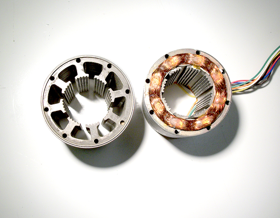

A problem with magnetic iron is eddy currents that generate iron losses. To limit these losses the iron needs to be made into thin plates known as laminations. These laminations are punched, stacked, and bonded together to form magnetic structures such as the motor stator shown below.
In concept this is relatively simple, but from a manufacturing point of view, the larger the diameter, the bigger the punch press, and the bigger the required punching die. The larger the initial sheet of metal, the more scrap there will be; a small motor contains less material, so it is less expensive to mass-produce. Roughly speaking, the cost of the capital equipment and the material content of the motor increases as the square of the motor radius. This cost function creates economic pressure to constrain the diameter of the motors.
