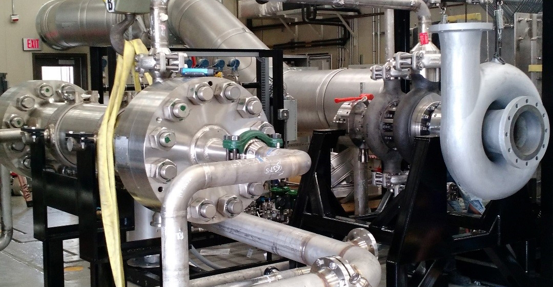

This hardware is part of DoE’s effort to test and demonstrate machinery for getting cost-effective power from solar power stored and concentrated as heat using CO2 thermodynamics. (Photo courtesy of Southwest Research Institute)
