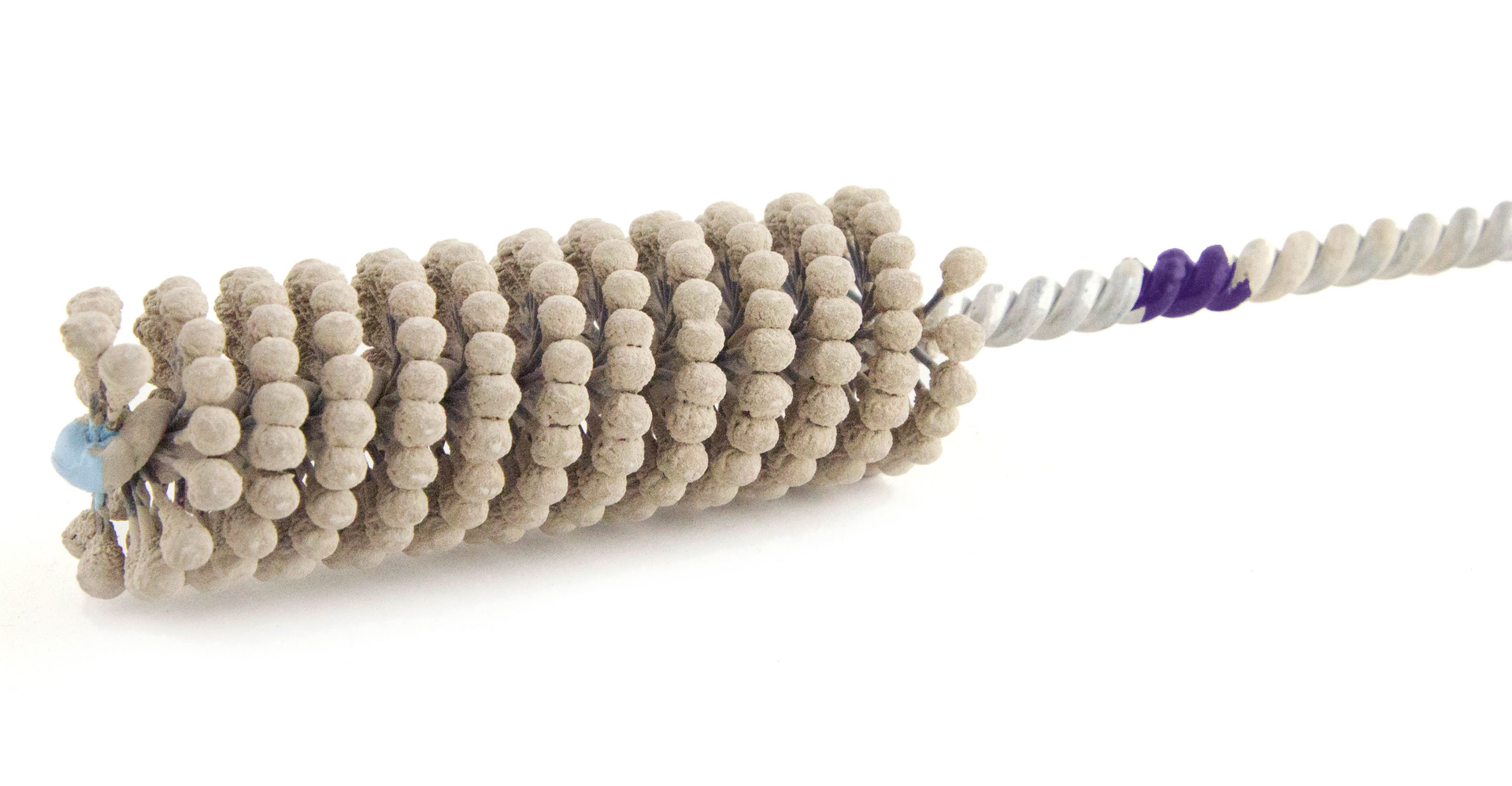

For many machine shops, a flexible hone is a much more efficient tool for overall surface finishing. The low-cost tool is often used for sophisticated surfacing, de-burring, edge-blending, and cleaning.
Brush Research Manufacturing (BRM) now offers CBN surface finishing solutions part of its standard product line. Somewhat resembling a spinning bottlebrush, the Flex-Hone tool is characterized by abrasive globules that are permanently mounted to flexible filaments that are attached to a center shaft. With its low-pressure, low-temperature abrading process, BRM’s CBN Flex-Hone tools can remove work-hardened layers and deburr parts without disturbing the underlying metallurgical structure.
Standard CBN Flex-Hone tools come in sizes ranging from 4mm to 20mm in three different mesh sizes: 170/200, 800, and 2,500. Larger sized products from 22mm to 38mm and additional mesh sizes are available by special order.
