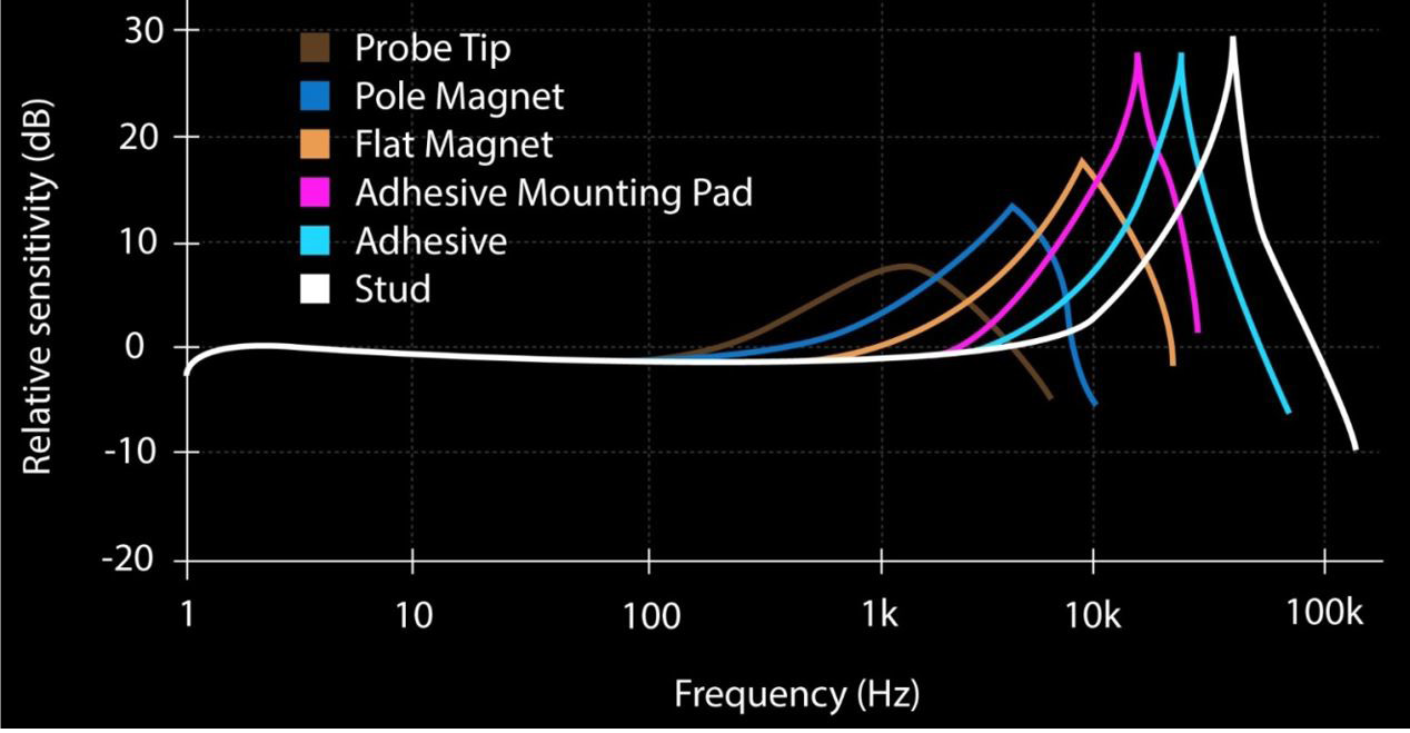

Accelerometer Mounting
The method used to mount the accelerometer to the vibrating structure and the coupling between the sensor and the measurement point is critical to obtaining accurate results because they influence the resonant frequency of the accelerometer.
Com­mon mounting methods
Stud mounting is the best mounting method in terms of accelerometer performance and will maximize the frequency response of the accelerometer. It’s important to torque the accelerometer down to the manufacturer’s specifications; inadequate mounting torque can reduce the frequency response. Perhaps the most important factor when stud mounting is to use a coupling fluid such as grease, oil, petroleum jelly or beeswax. Using a coupling fluid solves a lot of mounting problems, including inadequate mounting torque, surface flatness, and surface roughness.
Adhesive options vary, but the most important parameter for accelerometer performance is not the type of adhesive, but the thickness of the adhesive used.
  • Loctite or a two-part epoxy offers a permanent mounting option that improves repeatability and measurement time.
  • Wax or duct seal putty isn’t as effective as Loctite or epoxy but still offer surprisingly good frequency response and removal of the accelerometer is much easier.
  • Double-sided tape offers the lowest frequency response of all the adhesives, but for many applications, it is still effective. The thickness of the adhesive is the most important factor.
Adhesive mounting pads offer the very high-frequency response of adhesives and stud mounting but allow swapping out accelerometers easily. For large structures, it is much easier to instrument the structure with adhesive mounting pads first, then attach the accelerometers for the test. At the end of testing, the accelerometers can easily be removed and moved to the next test project. If, after analyzing the data, the team determines more testing is needed, having the mounting pads remain on the structure ensures the tests can be repeatable. Adhesive mounting pads also prevent epoxy from damaging expensive accelerometers.
Magnetic mounting bases allow easy, mess-free accelerometer mounting on ferrous structures for short-term measurement applications. Use caution with magnetic mounting bases to avoid structural damage or personal injury.
Handheld or probe tip options are a possibility with applications that are difficult to reach for proper mounting and/or have sensitive coatings or materials that prevent using adhesives or bolting. A probe tip can be used to press the accelerometer to the structure manually; this drastically reduces the measurable frequency range to less than 100 Hz or so. They are not recommended for frequency ranges less than 10 Hz.
