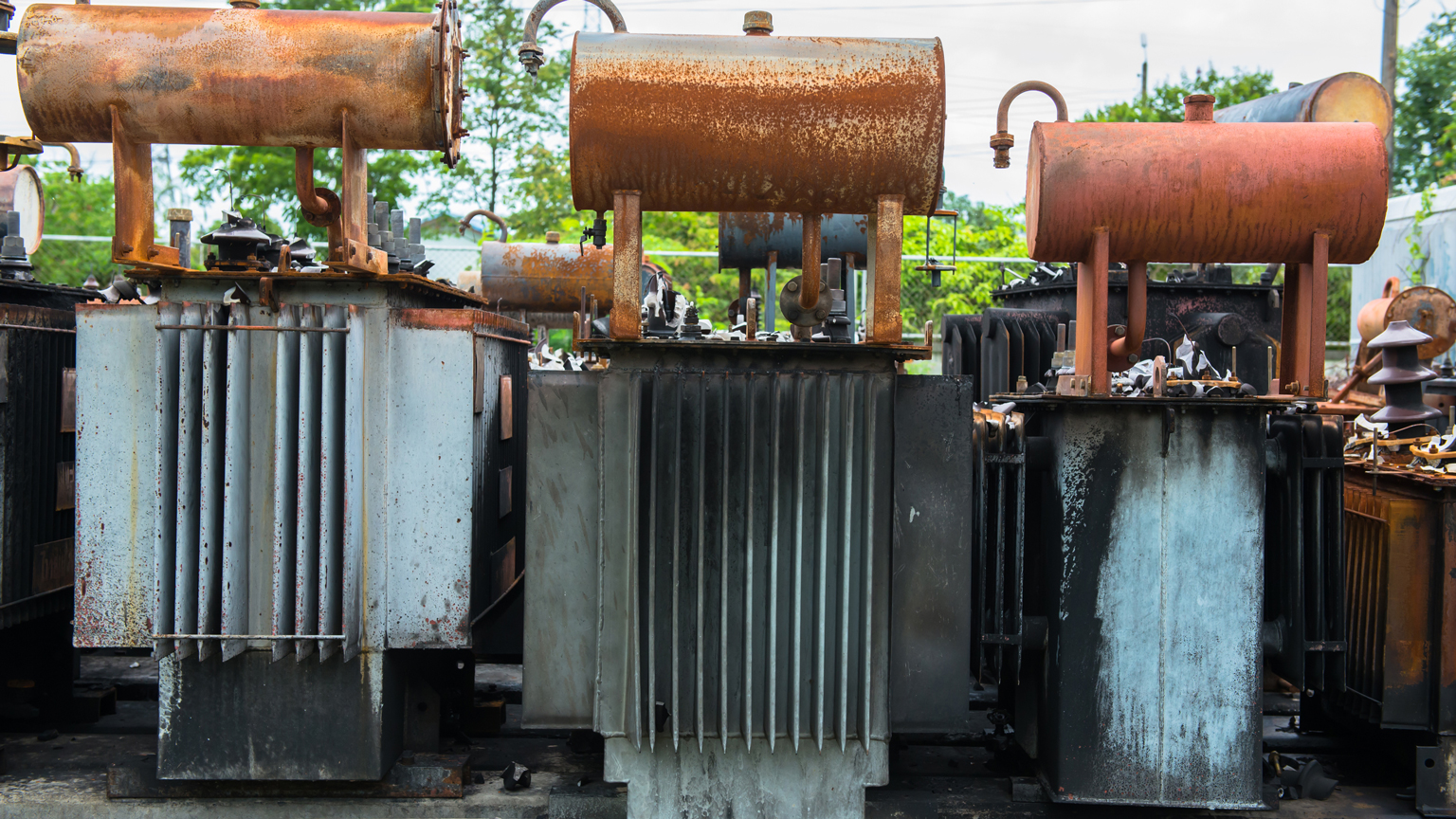

A “transformer investigator” says that based on his years of analyzing transformer mishaps, the main culprits are usually poor design, low quality materials and shoddy craftsmanship.

“I’ve dissected numerous transformer failures,” says Jeff Jones, one of those transformer investigators and founder of Electrical Certification Inc. in Cincinnati, a firm specializing in testing, certification and failure analysis. “After a transformer failure, the first thing out of the customer’s mouth is inevitably, ‘Hey, it’s just a year old! What happened?’”
Jones, a master electrician and test technician, has spent hours combing through the evidence and analyzing accidents. Based on that experience, he points to poor design, low-quality materials and shoddy craftsmanship as the three main reasons why transformers fail prematurely.
