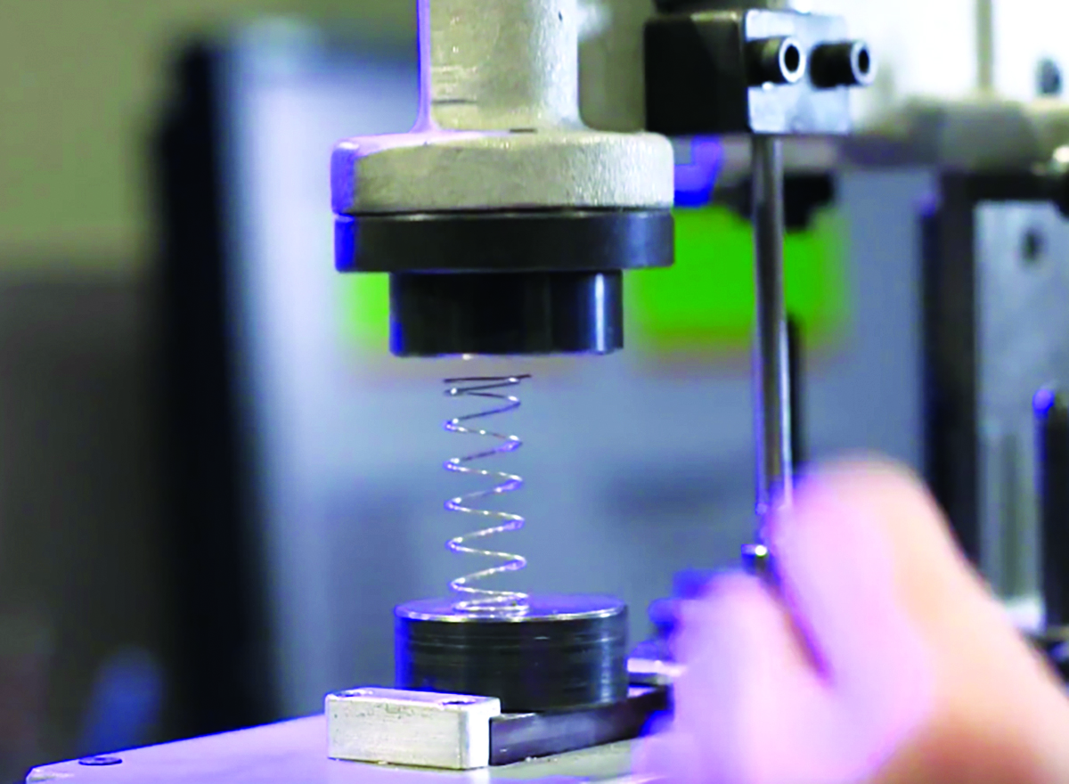

Spring index. The mean diameter of the spring divided by the wire diameter of the spring. It indicates how difficult it is to manufacture and shape the wire, the tolerance of the wire and, therefore, how much the spring will cost to make.
Spring rate. The pounds of force required to compress a spring by one inch. A spring’s strength comes from the volume of wire in the spring, which is determined by wire diameter and the length of the wire. Note: In the formula for spring rate, changes in the wire diameter are exponential to the fourth power.
Tolerance. A permissible range of force per inch from the spring rate that can be applied to the spring’s manufacture. This range is usually ±10% of the spring rate.

The actual spring index number can have many implications. A spring index between 3 and 20 is considered good because springs within that range will likely be easier and less costly to manufacture, and an index number of 7 has been a traditional rule of thumb because it is an achievable balance of spring strength and manufacturability. Springs can be made with indices outside this range, but that can give rise to potential difficulties.
For example, a large mean diameter versus the wire diameter can yield a large index and a soft spring that cannot hold the desired load. At the low end, a spring index below 3 may add stresses to the tooling, which would complicate manufacturing. To reach an ideal spring index for manufacturing, the designer has to raise or lower the mean diameter of the wire or the actual wire diameter.
However, diameter control in larger-index springs comes with another challenge: recoil. After the spring is wound, the wire immediately expands when the tension is removed. Smaller indices present less recoil, making the tolerance more controllable.
Once again, tolerance is a variable range of ±10% of the spring rate. Since wire diameter factors into the spring rate, it also affects tolerance, which is a percentage of the load—the amount of weight a spring is able to absorb when deflected a given distance. That range (expressed in pounds per inch) increases and decreases along with spring size.
If a spring has a high spring rate, its permissible range of force will also be high. A low spring rate means that the pounds of force that fall into that permissible range will also be small. Therefore, a design with a smaller wire diameter means the spring will be smaller and will also have a smaller load tolerance. Conversely, as the wire diameter increases, the spring is also larger, as well as its load tolerance (as shown in Table 2.1).
The size of the tolerance can affect how a spring is manufactured, thereby impacting production times and costs. Several design variables factor into a spring’s load tolerances, so be sure to work with a spring manufacturer that has the resources to assist you in achieving optimal results, especially if they fall outside ±10% tolerance. And, if your wire diameter is too large, it may not fit into its intended device.
