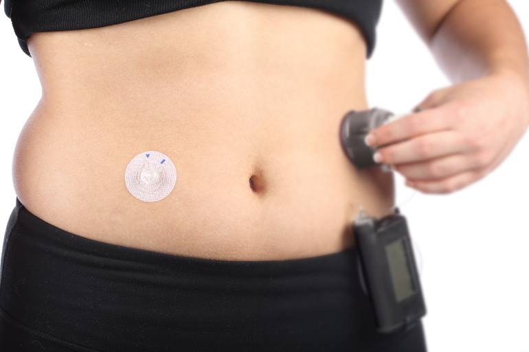

One design factor that can impact wearables is location durability. Devices are prone to catching on clothing and collisions with doors and obstructions—common causes of device failure or removal. Adhesive wear time is also a crucial consideration when designing a wearable device, impacting overall resilience and durability, as well as users themselves (e.g., how often they’ll need to change their device).
Device Size, Weight, and Location
As mobile phones, computers, and TVs get sleeker, so too must wearable medical devices. Both consumers and patients want wearable devices to be smaller, lighter and less cumbersome to use for seamless integration into their everyday lives. The design process can get challenging when devices must maintain accurate sensing capabilities, but also reduce friction to ensure precise data collection. Adhesives can help to keep friction to a minimum by being breathable and maintaining a low profile. In addition, options with flex electronics, as well as addressing battery implications and electromagnetic interference, provide opportunities for advancement.
Device location is also critical. The upper arm can be a good location for “hiding” the presence of the device, but it’s a body part prone to catching on clothing and colliding with doors and obstructions—common causes of device failure or removal. If the upper arm ends up being the chosen location for the device, special consideration should be given to the design of the device edges and profile to minimize catching on clothing and collisions. An adhesive skirt can also improve the overall survival rate of devices in all locations.
