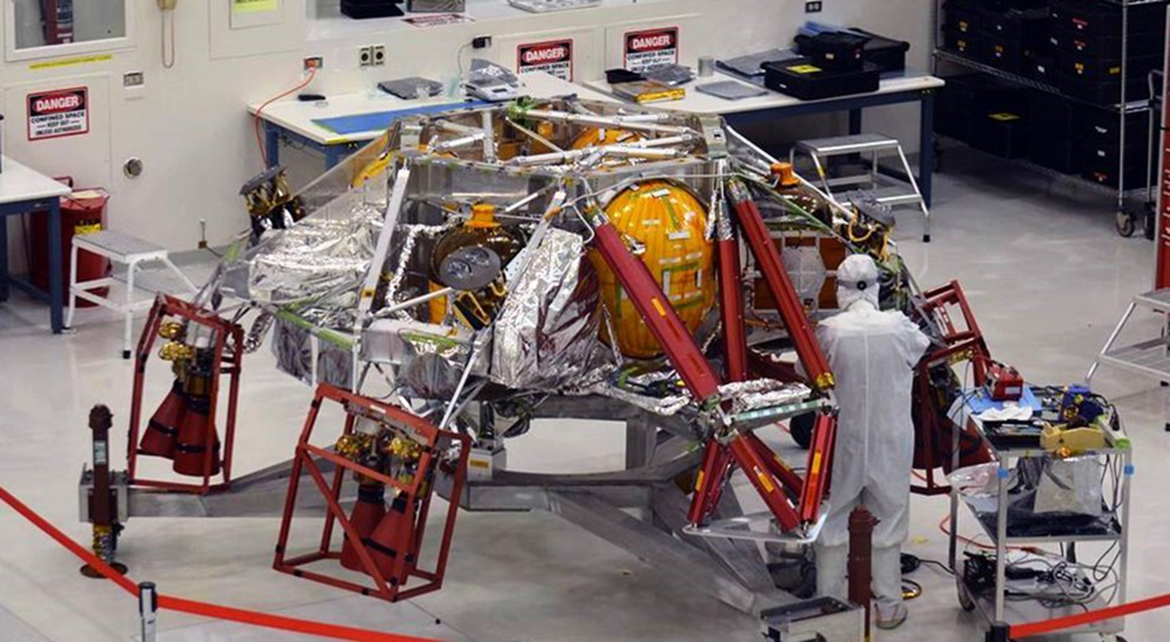

The first planned assembly, test, and launch operations (ATLO) activities of the Mars 2020 mission will involve electrical integration of flight hardware into the descent stage. The Mars 2020 rover, as well as its cruise stage, aeroshell, and descent stage—a rocket-powered "sky crane" that will lower the rover to the planet's surface—will undergo final assembly at the Spacecraft Assembly Facility High Bay 1 at NASA’s Jet Propulsion Laboratory (JPL) in Pasadena, Calif. (Fig. 1).
1. A technician works on the descent stage for NASA’s Mars 2020 mission inside JPL’s Spacecraft Assembly Facility. Mars 2020 is slated to carry NASA’s next Mars rover to the Red Planet in July of 2020. (Credit: NASA/JPL-Caltech)
