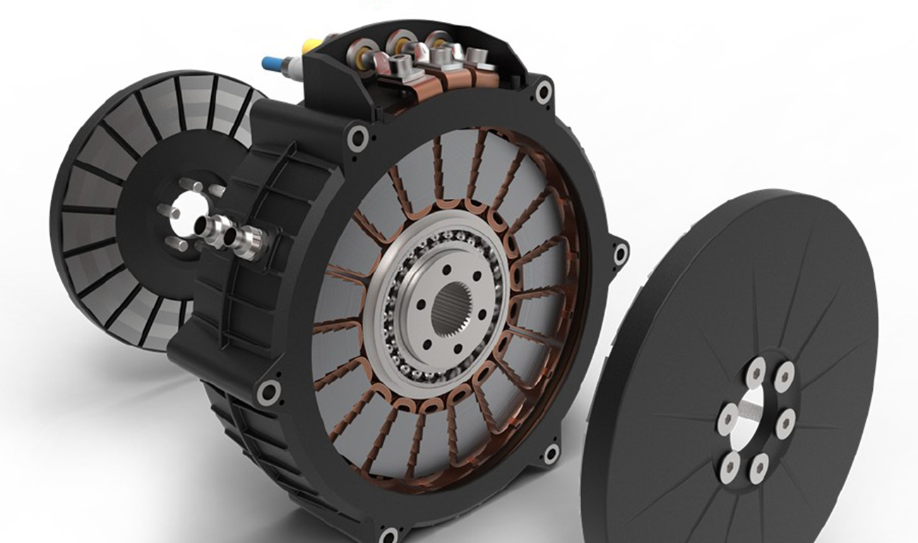

Mechanical: The high magnetic forces acting between the rotor and the stator produce an engineering and material challenge in maintaining a high-tolerance uniform air gap between these two components. Magnax solved this by improving the design.
Thermal: Windings in an AF machine are located deep within the stator and between the two rotor discs, which presents a greater challenge in terms of cooling than for an RF DD design. Magnax solved and patented a new concept where aluminum pieces surround the cores and extract the heat directly to the outside of the machine. As a result, there’s no need to push fluids through the cores (which can generate local turbulences and air bubbles, and lower structural strength). On the outside, cooling is accomplished via cooling fins or by installing a water jacket.
Manufacturing: AF machines have thus far been very difficult to manufacture because the stator iron’s design has continued to be based on that of an RF machine, using a stator yoke to close the flux loop. Magnetic forces between the rotor and stator discs tend to make it very difficult to keep the air gap between them uniform. If they start to wobble or bend, the discs can start rubbing against one another, leading to bearing damage at best, and rapid, spectacular unscheduled disassembly at worst.
Magnax’s solution was first to remove the iron yoke from the stator, but keep the iron teeth. Then, there are two rotor discs with the stator between the discs. A small air gap exists between rotors and stator, which contains the windings, while the rotors contain the magnets. The two rotor discs exert an equal (but opposite) attraction force on the rotor.
The discs, however, are directly connected to each other via the shaft ring, so the forces cancel each other out. The internal bearing doesn’t carry these forces; it only needs to keep the stator in the middle between the two rotor discs. Theoretically, when the stator is exactly in the middle, it’s in equilibrium and no forces act upon the bearing, although there’s always a small force that acts on the internal bearing.
