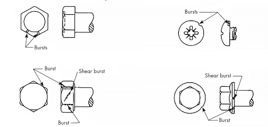

A burst is an open break on the flats or corners of the fastener’s head or at the periphery of a flanged or round headed fastener. They are created during heading. A shear burst is an open break in the fastener’s surface at approximately 45 deg. to the faster’s axis, and usually located on the periphery of fasteners with flanged or circular heads or on the side of hex heads.
Bursts and shear bursts are typically caused by metals that lack the necessary ductility for a given upset ratio during heading. Bursts can also be caused by impurities in the material, such as inclusions.

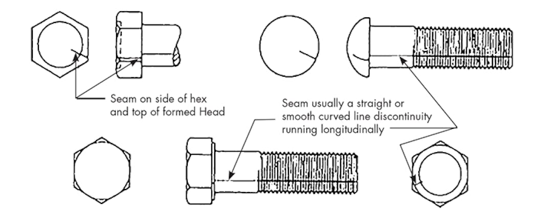

A seam is a straight or smooth-curved-line surface discontinuity running longitudinally on the fastener’s body and head. It is created when the cast billet is rolled into a rod and the billet contains a subsurface inclusion or void that becomes elongated during rolling. Seams can also split open in locations of greater metal flow, such as at the head or at periphery of flanged or round headed fasteners.
Impurities that cause seams result from several different events during steelmaking. This makes prevention complex for large-scale steel manufacturing processes. Through years of trial and error, steel manufacturers have learned how to reduce inclusions and impurities. Some of these techniques include selecting the right steel charge, better control of casting temperatures, ladle stirring, modifications to the designs of the tundish and nozzle, and close control of cooling rate. However, antiquated melting/casting infrastructure and machinery make it next to impossible to eliminate the problem. Clean steel practices are achievable in newer steel foundry and casting facilities. However, even with advances in clean steelmaking, seams and split heads have not been completely eliminated by fastener manufacturers.
