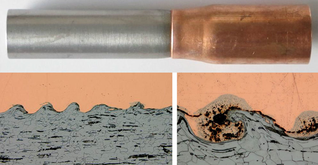

One of the first set of experiments within the JOIN’EM project was on copper-to-steel tubular joints, using copper tubes and cold worked carbon steel rods and tubes. The copper tubes had an outer diameter of 22.22 mm and a wall thickness of 0.89 mm. The outer diameter of the internal steel workpieces was chosen to obtain a stand-off distance of 1.0, 1.5, and 2.0 mm. Solid rods as well as tubes with a wall thickness of 1, 2, and 3 mm were used as internal joining partners. The tube-to-tube specimen configuration is shown in Fig. 1.

Experimental studies carried out in JOIN’EM have shown that with regard to leak tightness, the stand-off distance is a decisive parameter. Tube-to-rod specimens produced with a stand-off distance of 1.5 and 2 mm passed the leak test, proving their high weld quality. For a smaller stand-off distance, the acceleration and the corresponding impact velocity of the joining partners is lower, deteriorating the weld quality.
2. As-welded tube-to-tube copper-steel joint.
In addition, for the tube-to-tube specimens, the resistance of the inner tube against the impact of the flyer tube is important. Strength and stiffness (which is directly related to the thickness) must be sufficient to withstand the collision without extensive deformation of the inner tube. Accordingly, in the current example, leak tests have shown that a wall thickness of 3 mm for the internal steel tubes exhibited better leak tightness results than for a wall thickness of 1 and 2 mm.

Adding to the leak test, investigations of the interfacial morphology allow more detailed conclusions regarding the weld properties. An example of a metallographic cross section of a welded tube-to-tube specimen with a wall thickness of 3 mm for the internal steel tube is shown in Fig. 4a and b. In the overall view (Fig. 4a), the slight deformation of the inner tube caused by the colliding outer tube can clearly be recognized. The black line at the interface might suggest that no weld was obtained.
4. (a) The metallographic cross-section of a tube-to-tube specimen with a wall thickness of 3 mm for the internal steel tube; (b) Detail of the wavy bond formation at the copper-steel interface.
However, this can be explained by difficulties in the specimen preparation process of multi-material joints, especially if materials with significant differences in strength and hardness are concerned. In case of copper and steel, material removal will always be slightly more distinct for the softer copper, so that the surface of the copper and steel after polishing are not exactly at the same level. In case of moderate magnifications, the shift in the surface level appears as a dark line, which can easily be misinterpreted as a gap in between the copper flyer and steel target. If, however, higher magnifications are used, the shift in the surface level becomes detectable, because the focus has to be adapted in order to obtain a clear picture of the flyer or target surface. In Fig. 4b, a detail of the weld interface shows that a wavy bond has been formed between the copper and steel.
Figure 5 shows different copper-steel weld interfaces resulting from different sets of process parameters—specifically, different values of the stand-off and thickness of the inner tube. The extensions of the arrows indicate the length of the welded zone.
  • Gives an impression about a high-quality weld, characterized by a continuous interface with a completely welded zone showing the typical wavy structure. The other examples show weld defects, which might occur if the process parameters are not chosen well.

In general, the transition from a continuous to a discontinuous weld interface with non-welded zones takes place when the wall thickness of the internal steel tube is too small. Hence, a continuous weld interface with a completely welded zone is usually observed for tube-to-rod specimens and tube-to-tube specimens with a wall thickness of the internal steel tube of 3 mm or more. However, even for tube-to-tube specimens with a much smaller wall thickness of 1 mm of the internal steel tube, welded regions still can be produced.

Moreover, a correlation between the weld interface and the stand-off distance has been identified. A comparison of a stand-off distance of 1 and 2 mm shows the tendency of an increasing and more continuous weld length with increasing stand-off distance. However, for some parameter combinations, specimens produced with a large stand-off distance of 2 mm failed catastrophically due to cracks at the weld interface. To get a deeper understanding of this, a more detailed look at the micrographs is necessary.
Figure 6 illustrates different phenomena which can take place at the copper-steel weld interface. The high cooling rate can give rise to shrinkage cracks, while cavitation during melting can give rise to porosities. Intermixing of the materials can occur, resulting in interfacial layers. Under certain conditions, this can give rise to the formation of intermetallic phases. These phases should be limited, as they are likely detrimental to the weld quality due to its brittleness. Below a certain thickness, the intermetallic phases rarely contain defects, and when a wavy interface is present, these intermetallics are formed at the crests of the waves in melt pockets.2 This clearly shows that process parameters must be chosen well to avoid these defects, guarantee a high weld quality, and a robust manufacturing process.
