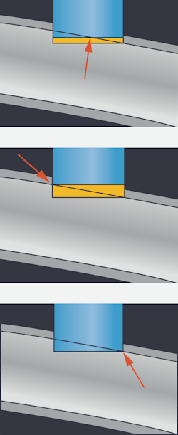

The above illustration shows three basic types of pins on a non-flat surface. From top to bottom, these include a center cut pin, which is indented on a curved part surface; shortest cut pin, which adds a pad, shown in yellow, above the curved part surface; and longest cut pin, which fully indents the pin into the part.
If a pin needs to act on a part surface that is not parallel to the pin-end, there should be a pad, provided it is in the same plane as the pin-end rather than that of the part surface. Because it is in a different plane than the part surface, the pad may be raised slightly above the part surface or recessed slightly below the part surface at one edge. Configuring a pad that is slightly recessed into the part surface is the default configuration for pins on contoured surfaces.
The default configuration is a center-cut pin, which on an angled or curved face means the pin hits tangent to the surface. There are two other options besides just center cut: Shortest leaves the standing pad under pin, while longest fully indents the pin into the part.
Keep in mind that with the shortest pin, you will be making a thicker section of plastic—which, if too thick, could lead to sinking on the back side of the part. Additionally, a longest pin (which is fully indenting) makes the plastic area thin, so designers should make sure it is not so thin that you end up with a hole in the part on account of a short shot or the pin punching through the surface entirely. You can work with molders’ applications engineers to discuss pin locations and type on critical areas to ensure molding and part design concerns are resolved.
