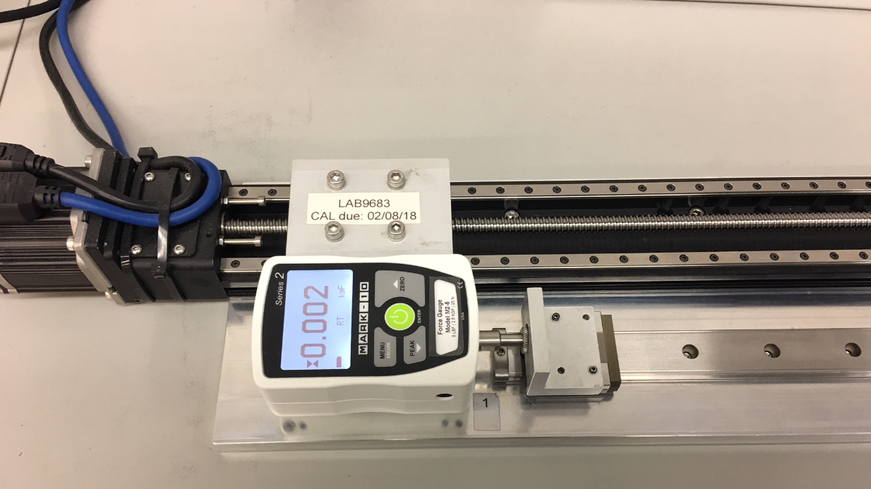

Not testing over full run of travel. You can’t fix a problem if you don’t know it exists. Linear guides need to be tested after assembly over the full run of travel. If it is not possible to measure parallelism directly, add an inspection step for measuring the push force of the carriage (Fig. 4). The push force should be consistent to within about 20% when moving the guide from end to end. If push force spikes at one point, frequently this will occur at one end of the guide; it may indicate that the rails are out of parallel and they need to be realigned.
4. A push-force gauge can be used to evaluate the effects of misalignment on the friction of a linear guide. Push force should be consistent to within about 20% over the full distance of travel; a spike may indicate misalignment.
