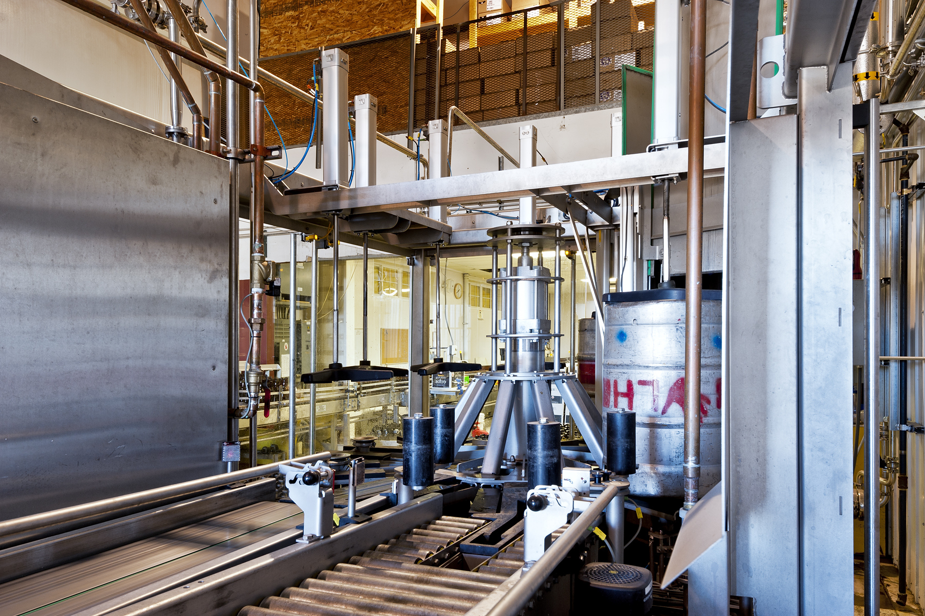

Mounting cleanline cylinders with integrated valves and controls on top of this keg racker and washer saves space and makes washdown easier. (Photo © Norgren, Inc.)
Left Hand Brewing Company, Longmont, Colo., needed new kegging equipment to handle rapidly growing demand for its popular stouts and ales. But the brewery’s space was so severely limited that the new kegging line would have to share space with a loading dock. Existing linear systems consumed more space than Left Hand could afford. It needed a system to clean and fill kegs that was compact and fast, and it also wanted to save on energy costs. And of course, the kegging line would have to meet beverage handling washdown requirements.
The solution was the Innokeg Till CombiKeg built by KHS, Dortmund, Germany. This unusual keg racker and washer uses a rotary design instead of a straight line, moving the kegs in a circle through the required stages of washing and filling. Installing multiple IMI Norgren IVACs on top of the machine makes this compact design possible, and with an ingress protection rating of IP67, the cleanline IVAC withstands the frequent washdowns required in this busy facility.
