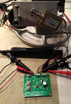

To compare the electromechanical performance of different solenoid drive schemes, a simple test setup was built using a servo potentiometer connected to a solenoid with a flexure to measure the motion of the solenoid. Motion, along with voltage and current, were captured using an oscilloscope. An MPS MPQ6610 IC was used to drive the solenoid.
The setup is shown in Figure 2.
2. The test setup involved a servo potentiometer connected to a solenoid with a flexure.

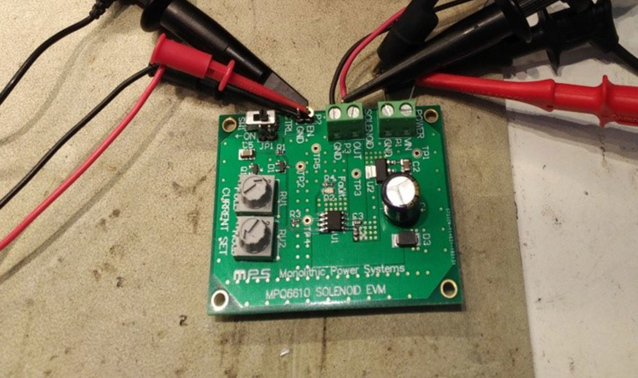

5. Shown is the MPQ6610 reduced hold current circuit.
An MPS MPQ6610 half-bridge driver, along with a few external components, can accomplish this task (Fig. 5). The MPQ6610 is a rated for up to 60 V and 3 A and is available in small TSOT and SOIC packages.
The resulting drive waveforms are shown in Figure 6. The yellow trace is the OUT signal driving the solenoid, and the green trace is the solenoid current. Initially, the full supply voltage (24 V in this case) is driven to pull in the solenoid. After a delay, the current is reduced by pulse-width modulating the output. The pull-in time is reduced to 16 ms, and the holding power dissipation is much lower (around 600 mW instead of 10 W).
6. These are the reduced hold current waveforms associated with the MPQ6610.
This circuit works like this:
Initially, the input signal is low. This discharges C1 through D1, and holds the ISET pin low through Q1.
The input signal goes high, which enables the MPQ6610 and drives the output high, applying the full supply voltage to the solenoid. C1 starts charging through R1. Current is sourced from the ISET pin proportional to the current flowing in the solenoid. As C1 charges, the voltage on the ISET pin is allowed to rise.
Assuming there’s sufficient current flowing in the solenoid, the voltage on the ISET pin continues rising until it reaches its current regulation threshold (1.5 V). At this point, the MPQ6610 starts regulating the solenoid current. The regulated hold current is set by the value of R2.
The delay time (where the solenoid is driven at 100% duty cycle) is set by the values of R1 and C1. For a standard 3.3-V logic level, the time is approximately 0.33 × RC. For the example above, with R1 = 100 kΩ and C1 = 2.2 µF, 0.33 × RC = 75 ms.
