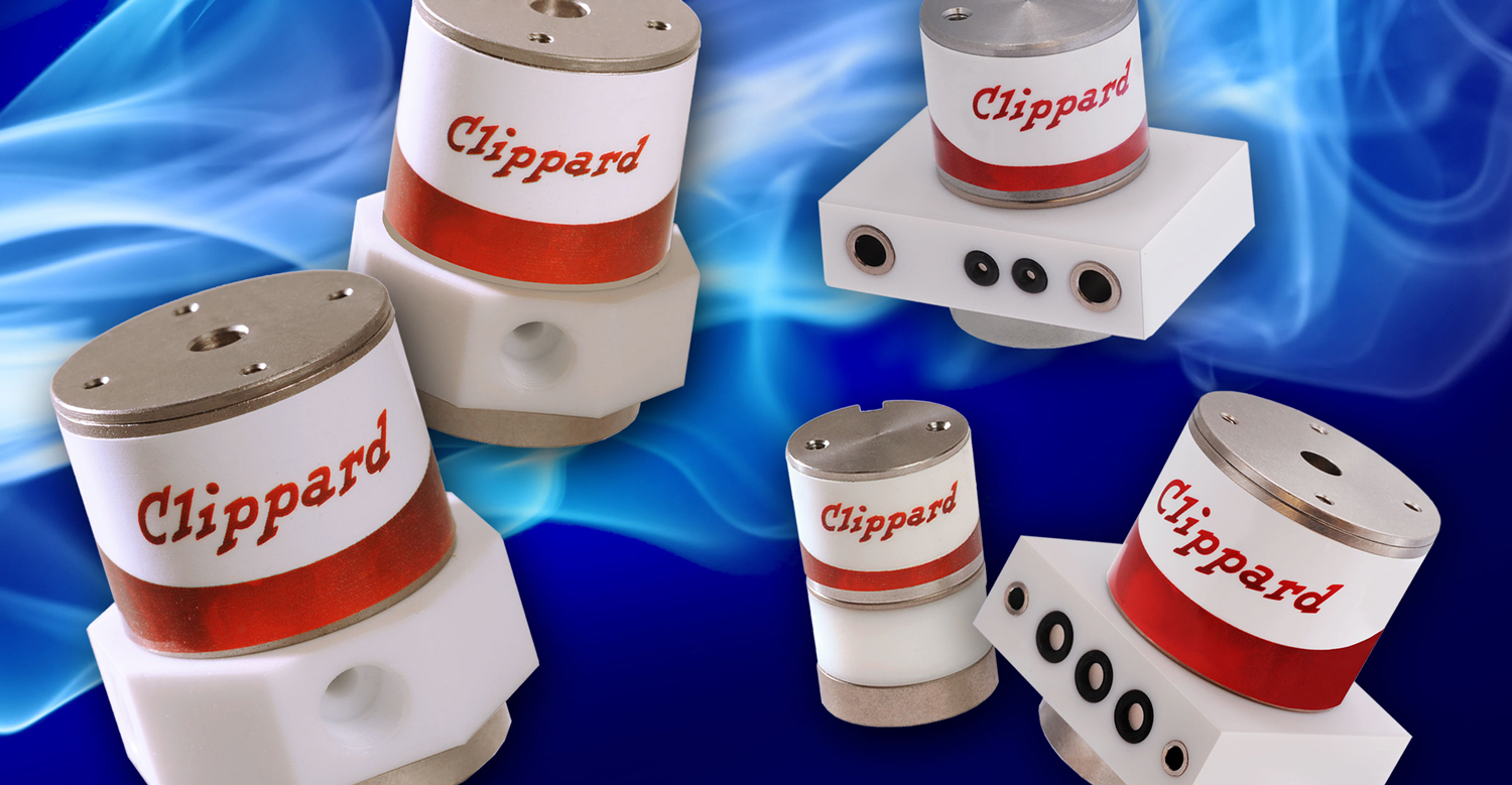

Fig. 1

Diaphragm Isolation Valves
A diaphragm isolation valve—also known as a “membrane valve”—is a solenoid-operated device that uses a diaphragm that extends and retracts to seal the valve seat and isolate the flow path. Like rocker valves, diaphragm valves can be configured as simple on/off two-way or three-way devices.
Compared to the rocker valves, diaphragm valves have much longer life, are better swept, and have much less dead volume—some as little as zero. Another benefit of these valves is that the diaphragm can be made from non-elastomer materials such as PTFE, which eliminates the need for seals and provides more chemical compatibility. This type of valve can be made of inert materials, including an entirely inert fluid path. This makes them ideal for applications involving corrosive media.
The NPV Series Miniature Pinch Valve from Clippard is available with one or two tubes. The single tube versions act as standard on/off two-way valves and can be normally-open or normally-closed. The two-tube version have a normally-open tube and a normally-closed tube, letting them function as three-way valves.
When selecting this type of isolation valve, it is important to consider the diaphragm material and the media that will be used. Some diaphragm valves use elastomeric membrane such as FKM or EPDM. These materials are highly flexible, which lets them tolerate small amounts of fine particles, but common chemicals such as methyl alcohol or ammonia can damage them. For chemotherapy treatments or other applications involving corrosive media, valves need more chemically resistant diaphragms made of materials such as PTFE.
When choosing a valve for use with corrosive media, it is important to ensure all wetted materials are inert. For the longest lifespan and lowest risk of cross-contamination, the flow path and all wetted areas of the valve should be constructed of an inert material compatible with the media that will be used.
