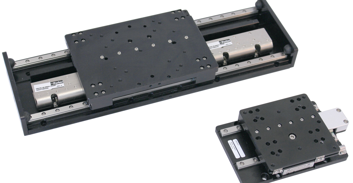

Modular ironless linear motor stages, such as the mSR100 (the larger actuator), offer various base sizes, travel lengths, and motor sizes to accommodate large applications. Ironcore linear motor stage, such as the mSR 80 (the smaller actuator) from Parker, combine a high level of force with a small footprint and highly precise movement thanks to a patented anti-cogging design.
