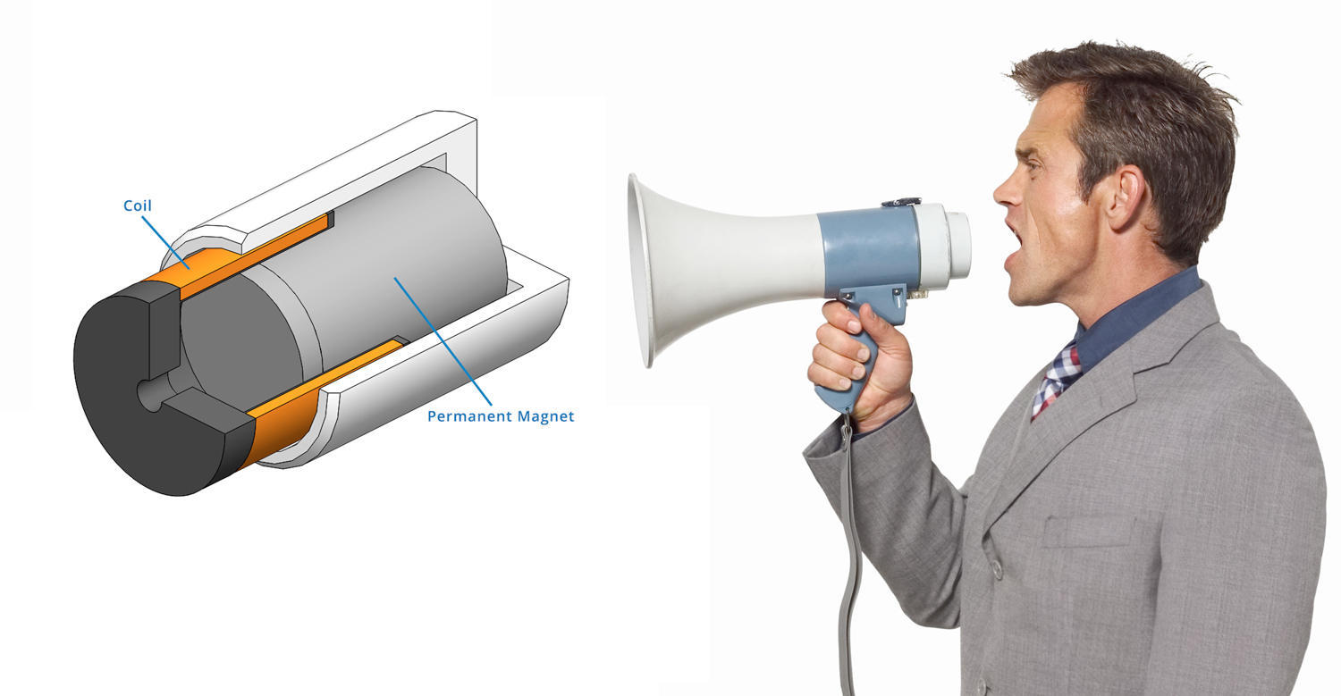

Either the coil assembly or permanent magnetic field assembly can be used as the moving member in a voice coil actuator.
Moving Coil
Voice coil actuators come in a variety of packages. The standard type, which most people are familiar with, are moving coil type actuators. These typically involve a coil wound around a bobbin—which can be made from many non-magnetic materials—which moves in and out of a permanent magnetic field assembly consisting of a steel housing with a concentric permanent magnet assembly in the middle.
The image above is the standard type of voice coil actuators with a moving coil.
Moving Magnet
Another common type of actuator would be the moving magnet design, where the coil is fixed and magnet assembly moves. This construction change would prevent moving leads during operation. The package operates similarly, but instead of an exposed coil that moves in and out of the magnet assembly, the moving magnet style utilizes a permanent magnetic field assembly “piston” moving inside a cylindrical coil tube. This style often comes with the permanent field assembly attached to a shaft, and end caps containing bearings so that this style is most commonly supplied with an integrated bearing system.
The moving magnet is the common type of voice coil actuators.
