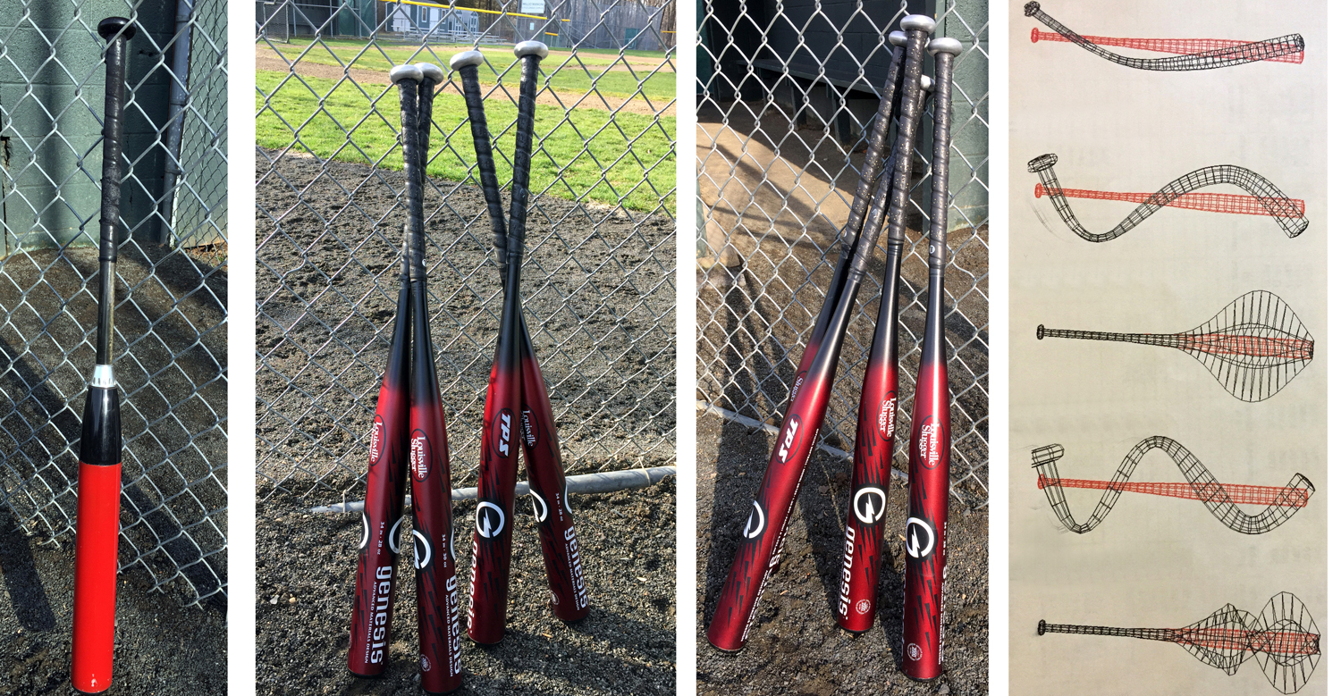

It seemed reasonable to believe that the frequency of one or more of a bat’s vibration modes might have some relationship to performance. As a test of that hypothesis, my team gathered up a dozen bats whose relative performance was known and sent them to an outside firm for vibration analysis. These bats included a range of manufacturers, models, construction materials, and player leagues (as shown in the table).
Testing analysis revealed that all bats shared a similar general shape for the first five modes of vibration, with modes 1, 2, and 4 being axial bending ,while modes 3 and 5 are hoop flexing.
Testing a dozen different bats revealed that they all share similar vibrational modes. Modes 1, 2, and 4 from the top are axial bending modes. Modes 3 and 5 are hoop flex modes.
Further analysis identified a very strong correlation between the first hoop mode (which is mode 3) and bat performance, with lower vibrational frequencies generally correlating to higher performance—something we described as constructive recovery of the hoop distortion in synchronization with ball/bat interaction. Another way to think of it is that lower frequencies correlate with softer barrel structures and easier distortion of the barrel wall.
Bats which distort easily in the hoop mode minimize deformation of the ball itself. And since ball deformation is usually much more highly damped and energy absorbing than deformation of the bat, more energy is conserved in the interaction (i.e., when the bat and ball collide).
So, the key to designing a good bat was to ensure that its hoop frequency had the hoop deflection fully recovering just as the ball was leaving. This was important. It gave us a design parameter easily evaluated using FEA and one we could optimize to get the best performing composite bat. But hoop stiffness is driven by a combination of composite fiber type, fiber orientation, ply stack thickness, and ply order within the stack. So, there were still there were a lot of variable to juggle to get both high performance and durability.

The design guidance—to focus on hoop frequency—worked great, and we immediately began turning out composite bats with performance characteristics as good as any aluminum bat on the market. The problem we immediately encountered, and one that continued to haunt us, was durability. We consulted closely with a composites engineer who had experience in designing impact resistant structures for the aerospace industry, but it turns out most of that industry’s experience is with unintended impacts, such as a wrench dropped on a composite wing skin.
We, on the other hand, were dealing with repeated impacts, all violent in nature, and generally occurring at the same spot. It was an incredibly demanding design condition for a composite structure, especially given a market-driven requirement that the bat withstand at least 500 impacts before failure. Importantly, this number was driven by the anticipated number of at-bats a league player might expect in a single season and was tied to the industry warranty standard of “one year, one replacement.”
We tried several different fiber combinations, eventually settling on one involving high angle (close to circumferential in orientation) fiberglass for hoop performance, low-angle carbon for axial bending stiffness, and aramid for general toughness and vibration damping. We also selected a tough epoxy resin developed by Dow Chemical to hold everything together and specified fiber sizing agents developed to enhance fiber/matrix adhesion for that epoxy. After months of effort, we finally got the go-ahead from our marketing partner, Hillerich & Bradsby, and launched production of a bat designated Genesis SB34 (a name that mysteriously emerged from the marketing department at H&B) using a manufacturing plant we setup in Guadalajara, Mexico.
