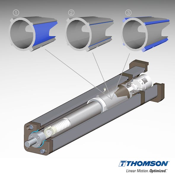

The image above from Thomson Industries is a cross section of an electromechanical actuator. Inside the actuator, side loads are handled by maximizing the surface area. By increasing the surface area, lateral loads are supported and helps reduce play in thrust situations.

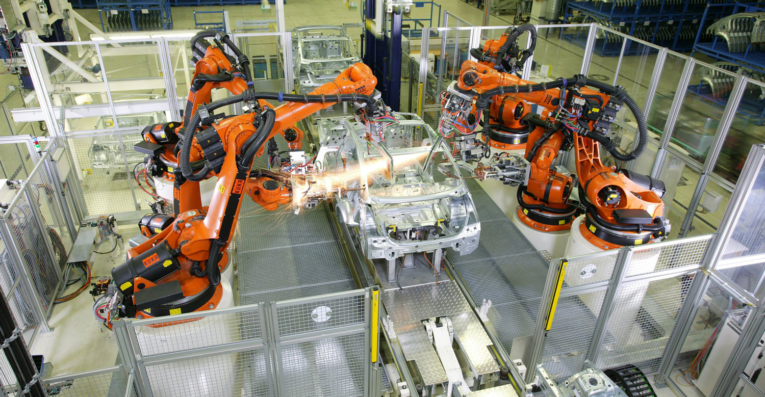

The Kuka robots are performing a welding operation with robotic weld guns. They are using electromechanical actuation to perform the various welds need on the car chassis.
