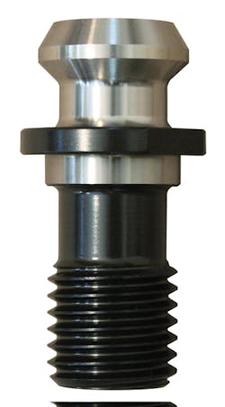

Benefits of a High Torque Retention Knob
The high torque retention knobs are designed with a longer reach so that they thread deeper into the threaded bore of the tool holder. Consequently, all thread engagement happens in an area of the tool holder where there is a denser cross-section of material to counter deformation.
They also feature a precision pilot, and are balanced by design to increase rigidity. What’s more, to guard against the high torque retention knob being over-tightened, which can still produce a bulge, the company provides specifically calculated torque specs based on drawbar pressure. By combining the high torque retention knob with the proper torque, spindle contact with the taper is improved to close to 100% every time, which drastically reduces vibration and chatter. High torque retention knobs work with all existing tool holders, including BT, DIN, ISO, and CAT tool holders from 30 taper to 60 taper.
