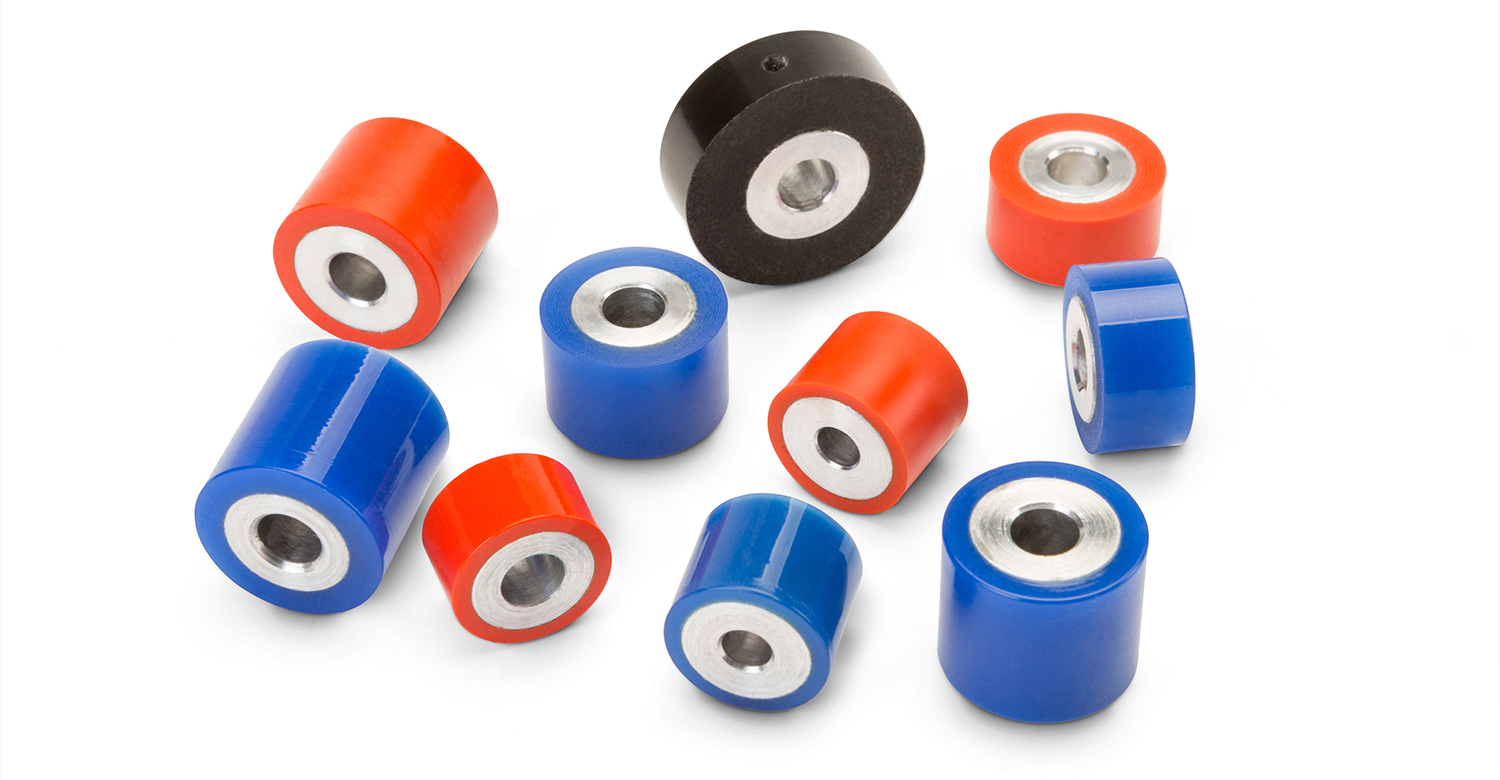

Urethane Rollers
Most wire-cutting rollers in use today are composed of urethane (short for polyurethane). Shorter rollers, which typically cut up to 30 wafers simultaneously, are made of high-performance cast and machined urethane. The longer rollers, which often cut up to 300 wafers, are often coated with urethane sleeves having similar properties.
“Urethane is the preferred material for both long and short wire cutting rollers,” says Greg Cappaert, technical sales engineer at Argonics, one of the U.S.’s largest producers of wear-resistant urethane products. “Cast urethanes are tough, abrasion-resistant elastic materials that combine many of the performance advantages of high-tech plastics, metals, and ceramics, along with the resiliency and flexibility of rubber parts.”
Because urethane’s properties can be adjusted over wide ranges of hardness, resilience, spring rate, and dynamic properties, its versatility offers custom solutions to difficult design challenges. Below is a list of urethane’s physical properites:

The image above shows where different urethane rollers fall on the hardness scale.
“Urethane, even in relatively small quantity production, can be adapted and tailored to prioritize the physical properties that design engineers need,” says Cappaert.
