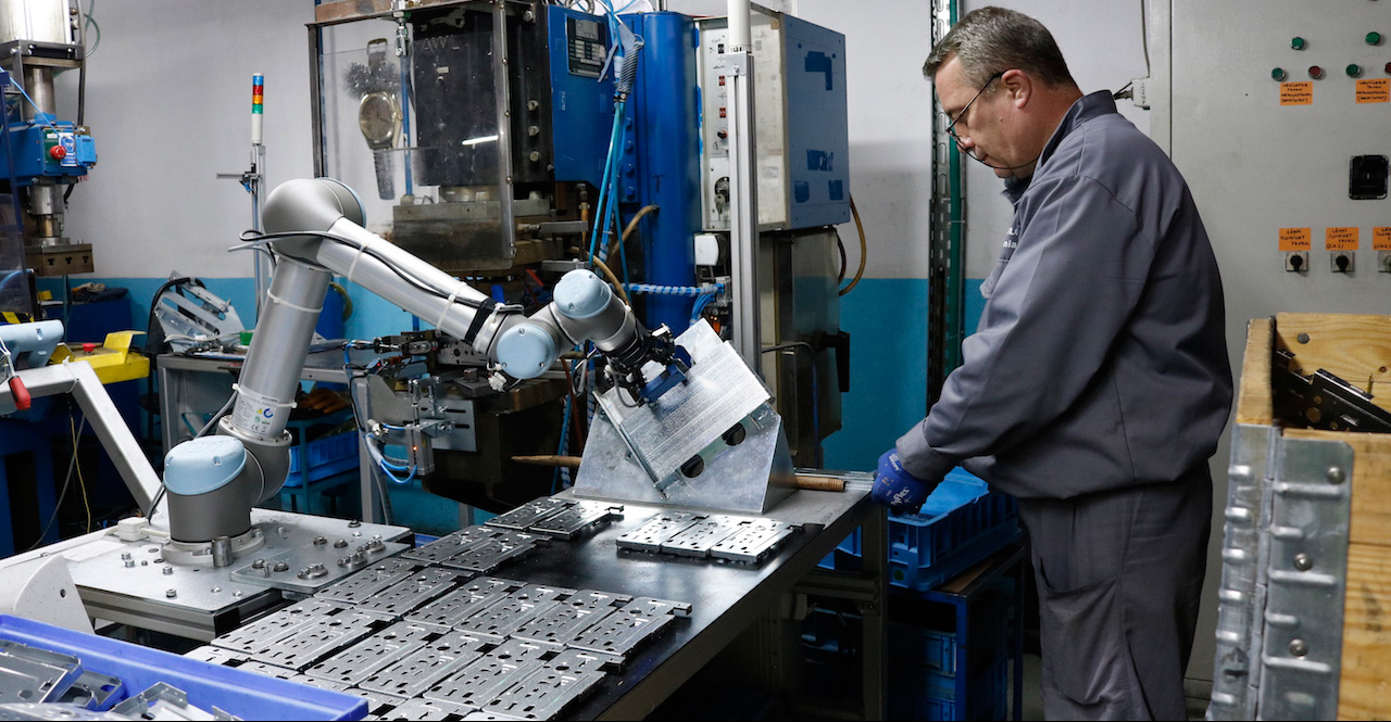

The facility started by automating the most simple and repetitive processes. “We wanted to automate the welded assembly between a front plate and a case,” explains Iosif. “There used to be an operator who put both parts together manually. We had in mind to build a flexible cell that could handle lots of parts at lots of stations.”
Cobots are able to load and unload parts to and from machines. In some factories there isn’t enough space to have robots that require safety enclosures.
 A Collaborative Solution for High-/Low-Volume Production
Collaborative robots rapidly emerged as a top solution. Iosif reached out to Razvan Isac, from local cobot distributor Robotsnet, to give this technology a try. “We were in discussion with AA for some small application project in the beginning,” says Isac. “We decided to lend them a Universal Robots model for one month. Since then we had very positive feedback from their side.”
“We also needed flexible end-effectors to suit our high-mix, low-volume production,” says losif. “We found an electrical gripper, made by Canadian company Robotiq, which adapts to parts of many different sizes and shapes. We also bought their wrist camera to locate parts. Anytime there is a new lock to assemble, I teach this new part to the camera. I can teach as many parts as I want. Then I choose which part I need, and that’s it—I changed the production.”
Locate, Pick, and Place Two Parts in 20 Seconds
Iosif wanted to automate the setup of a welding assembly that used to be done by a human operator. This included locating the front plate, placing it in the welding machine, picking the case, and placing it correctly over the plate on the fixture. Finally, the operator would press the button for welding. Beating this time with a robot wouldn’t be easy.
At first the robot couldn’t obtain faster cycle time than workers. Since it was so easy to program, however, Iosif and his team were eventually able to reach a 20-second cycle time. This would represent a 20% productivity gain while freeing human hands from a highly repetitive task.
This new process still requires a human presence (for now), but makes life a lot easier for operator Moise Nicolae. “At the beginning, I had some technical challenges with the robot,” Nicolae recalls. “But after a bit of time it became really easy, and it’s very simple to work with it. It’s a big difference for me working with a robot because my task is much easier.”
