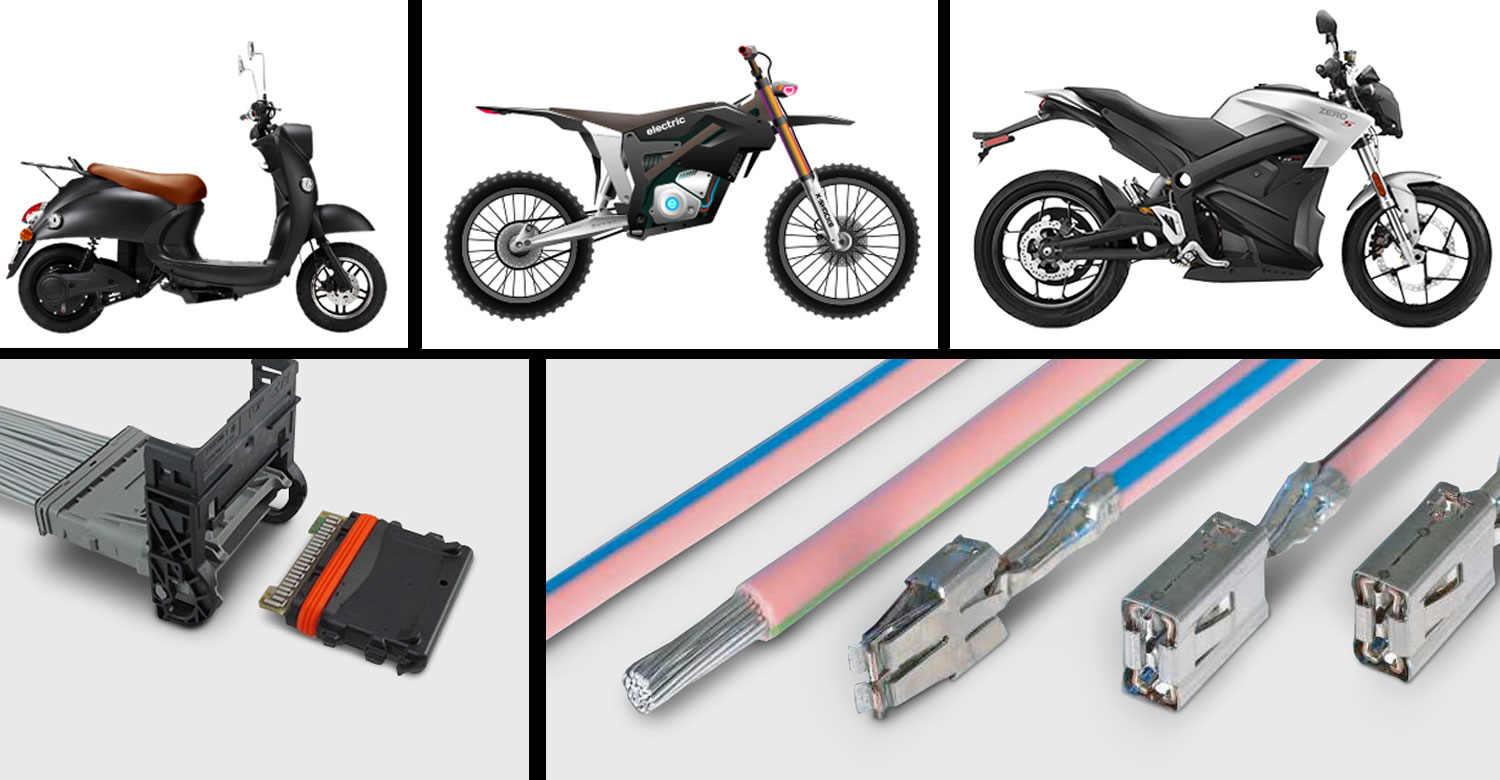

TE Connectivity’s SmartSeal connector features a rugged, compact design with a lever slide lock mechanism that secures the connector to an electronic control unit (ECU).
The many connectors and cables must be robust enough to ensure long-term signal and power integrity in the face of extremely harsh environmental and stressful mechanical operating conditions. Motorbike designers are already aware of the delicate nature of electronic devices, boards, and connectors relative to their mechanical counterparts. As such, they have learned to choose their connectors and route their cabling carefully, accounting for wide temperature ranges (−40 to 135°C), vibration, rain, and humidity.
TE Connectivity’s NanoMQS solutions support the need to reduce weight and space in two-wheel vehicles.

TE Connectivity’s LITEALUM wire-crimp termination enables a seamless, stable, and secure solution for aluminum wire in motor vehicles.
