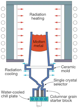

This schematic shows how manufacturers make single-crystal turbine blades in a mold inside a vacuum furnace.

Directional solidification is done in a vacuum chamber and involves pouring molten superalloy metal into a vertically mounted mold heated to metal melt temperatures, and filling the turbine airfoil mold cavity from root to tip (bottom to top). The bottom of the mold is formed by a water-cooled copper chill plate having a knurled surface exposed to the molten metal. At the chill plate surface, crystals form from the liquid superalloy, and the solid interface advances until it reaches the top.
The ceramic mold is surrounded by a temperature-controlled enclosure, which keeps the sides of the mold at a constant temperature distribution, and all the latent heat of solidification is removed by the chill plate. As solidification climbs through the mold, it is slowly lowered out of the enclosure.

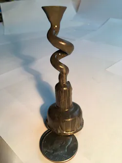

This pigtail (or starter chamber) was used to create a single-crystal blade. It was then cut off and the inside metal exposed and acid etched to bring out grain boundaries. You can see several directionally solidifying crystals growing up from the bottom (nearest the coin) and then they disappear to leave only one crystal emerging form the helical portion.

While casting DS crystals, AMRDL researchers found that if they put a right-angle bend in the casting mold just a short distance above the chill plate (called the “starter” chamber), the number of crystals climbing above the bend would be reduced. Putting in two such bends reduced the number even more. Later, it was found that a helical channel with smooth continuous turning was a natural filter, admitting columnar crystals from the starter and letting just one crystal rise above the helix and start to form the entire blade. This single crystal selector was dubbed the “pigtail.”
As the single crystal structure forms, the mold must be kept at the right temperature as the mold is taken from the heat-controlled enclosure. Any heat conducted to the sides of the mold lateral surfaces could lead to localized crystallization, which disrupts the single crystal structure with secondary grains.
